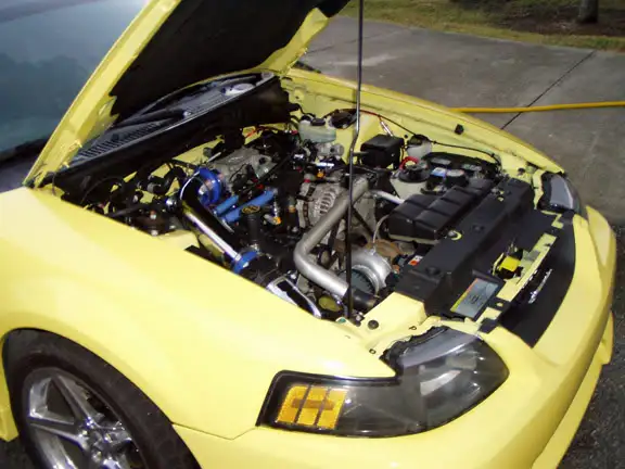

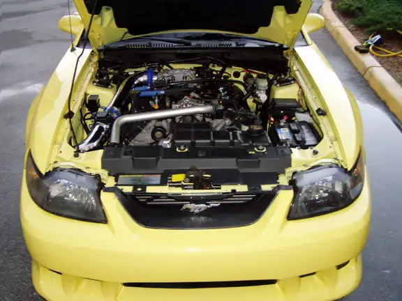

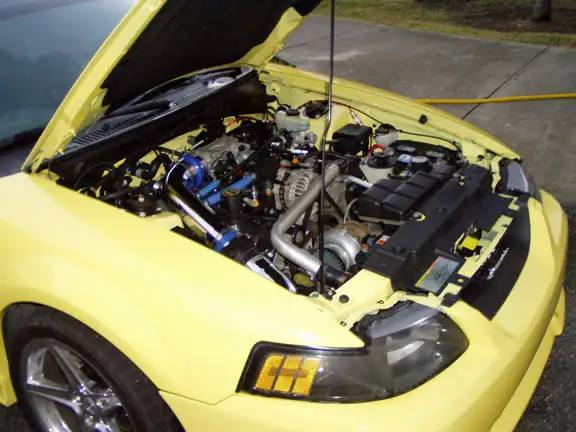

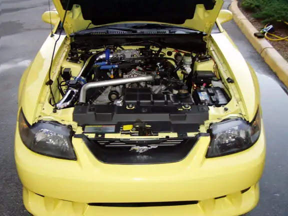

So last night I finished up the cold side piping.. If I would have only had the right silicone conectors and pipe it would have gone MUCH quicker.. But I had to make do with what I had, and finally have a completed turbo system.. minus the fuel and tune requirements.

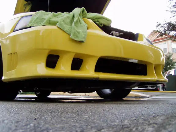

So yes, I reclocked the compressor housing downward, from there it's 2.5" over to the drivers side intercooler inlet.. 3" pipe out of the cooler up to my BBK air intake, which is 3.5" ( Figured I would resuse it since it looked pretty).. I plan on running the meter in blow through ( Pmas meter) on 42lb injectors. The fun part will be trying to drop the tank to pull the fuel pump.. Damn Saleen bumper will require removing the bumper too!
Total cost for me was only around $250 bucks or less I already had the turbo, wastegate, intercooler, and old H pipe.. I've totaled a setup out before for this car, and it came out to $1800 for everything including a tune.
