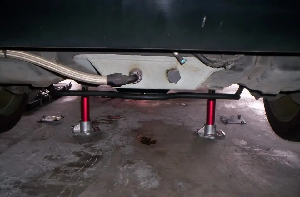

Project update 5 June 2006.
Went by Turbo Technology Inc. and took some spy photo's:
Turbo siiting were the battery used to be.
Driver side header.
Side view of Turbo.
Pasanger side header.
Driver side header and Turbo, you can see were the waste gate and cross over will be located.
They are still in the mock up phase since we want to keep the power steering, but when I went there and saw the big turbo sitting in there I started to feel a sensation in the pants:D
On my old TTI Street kit with the much smaller turbo was on the passanger side.
:flag:

Killercanary said:
:drool: :jaw:
I'm so excited for your buildup! Is that a custom PS bracket? Are you still running the stock front accessories and timing cover?
Nope, it's the stock brackets on both sides that I had powder coated black:D and the timing chain cover is stock also, just powder coated that also to match the brackets. All the Acc. are still stock:nice:
