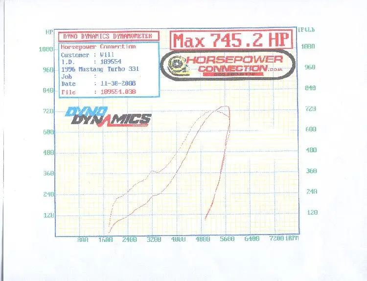

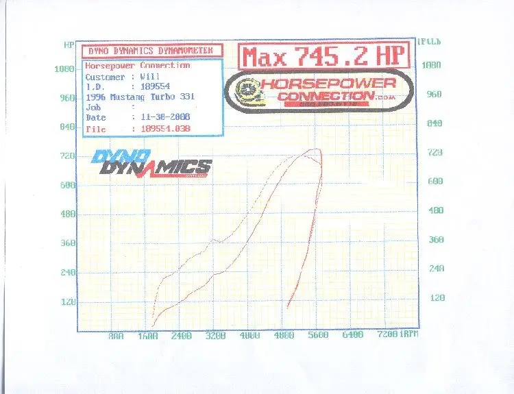

Here is the Dyno graph from the last pull, still need to lean it out more :D :
DART 331
AFR 185's
Trickflow R Box intake
F.A.S.T.
Bullseye S380R
3.5" Downpipe
92 Octane pump gas
AIS Meth injection
20 PSI
9.9 : 1 A/F ratio
Intake air temp @ 80 deg.

Any reason the pull stops @ 6k?
Is it because it is a new motor? Not broken in yet?
Seems like it was still climbing when you lt off...:shrug:
The motor is plenty broken in.
The reason we stopped around the 6k mark was 2 reasons:
1. Help reduce stress on the engine and have longer engine life.
2. Hydraulic-Roller Cams are pretty much tapped out after 6-7k in rpm and you can start to float valves.

While I understand the reasoning for #1...It still leaves me :scratch:
ISnt it a dart based forged everything? How would another 1-2K RPM be hurtfull on that stout of a bottom end.
Now I know if the valvesprings, pushrods, etc werent designed for that high of rpm it could be dangerous, but I wouldnt worry for even a second with the motor you have put together.
