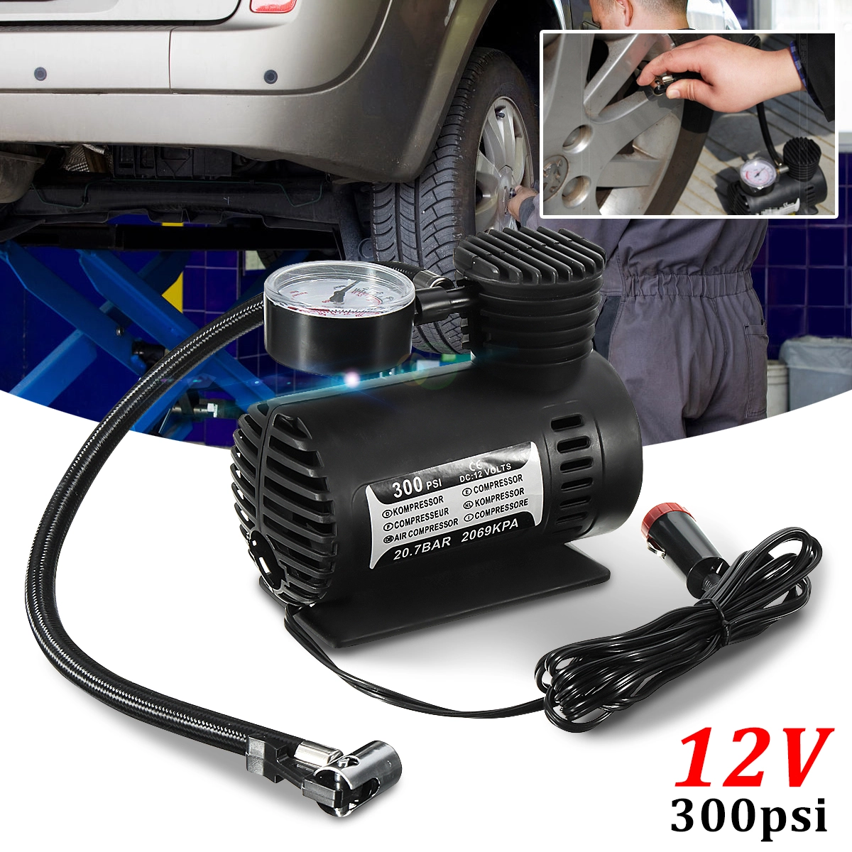

Do you have an old 12v accessory floating around that doesn't work anymore?
Cut the cord off of it and use it for your 12V power source. Don't dross the leads. In fact, crimp some alligator clips onto it and don't even plug it into the socket until you've made [certain] that is correctly connected to your test component.
