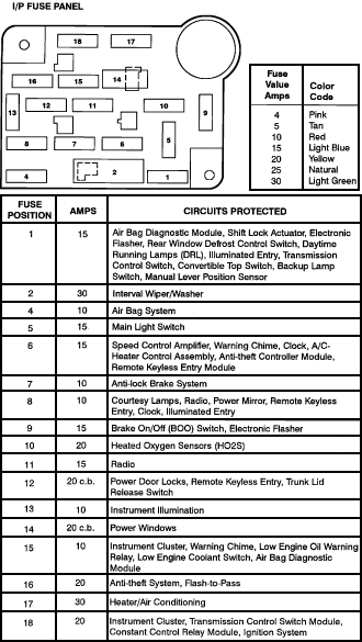

My turn signals arent working and i beleive it is probably one of my fuses blown. Thougth i do not have a fuse box cover.. I have no idea wich one goes to the turn signal. My car is at college, so i have no tools to test the fuses or anything, besides my eyes. I pulled them all out and they all looked fine, But i still want to replace it just to see if that fixes. So if anyone could tell me exactly which one goes to the turn signals that would be helpful. I beleive its a 15 amprage.. But im not sure
Neal
what is this relay? My right side will do the fast clicking noise where the right front blinker will not work, but it only does this half the time. The other half it will work fine, so the bulb cant be out. I was thinking it was some kind of bad connection inside the steering columnor something, i have no idea.
