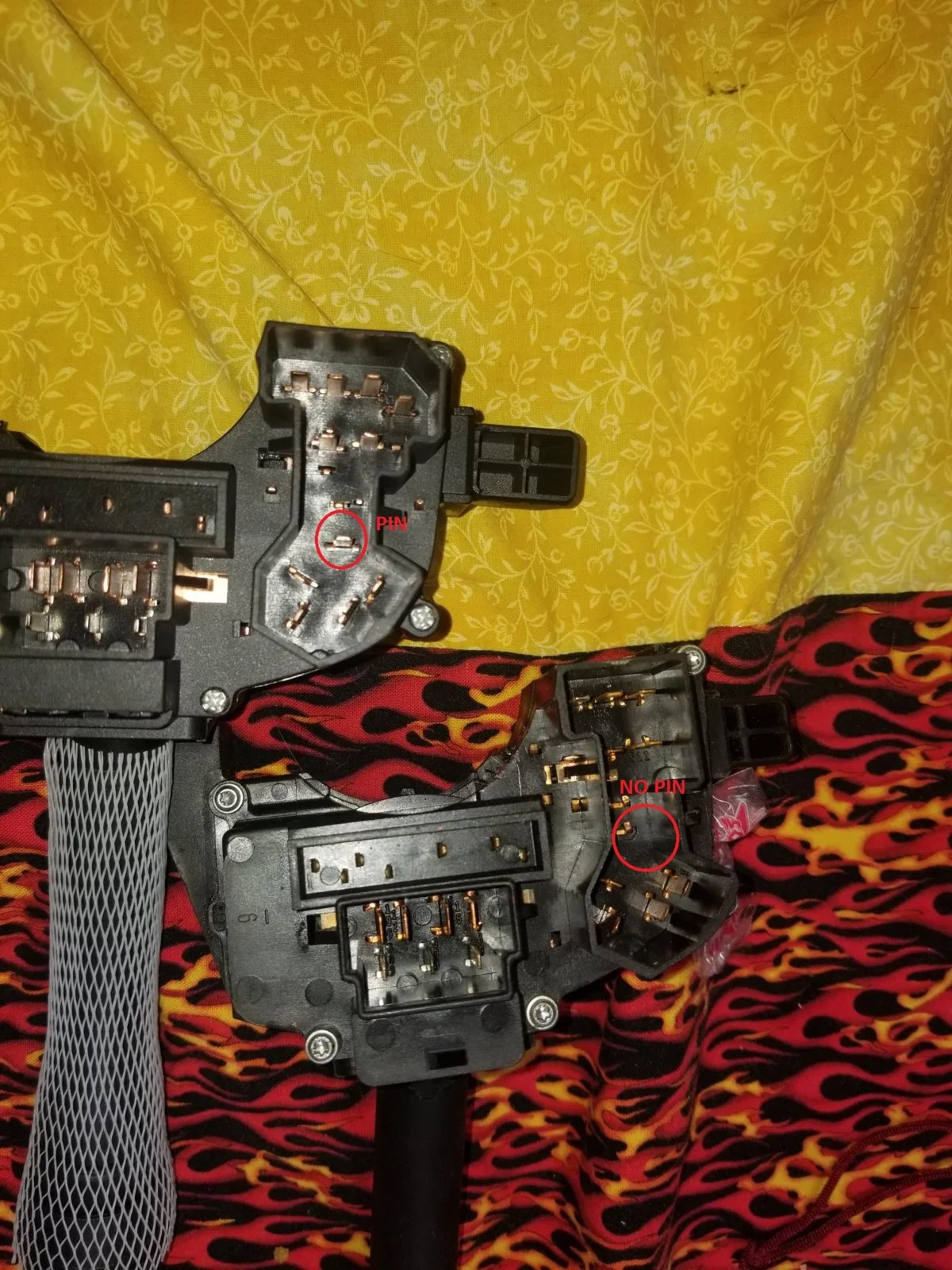

I need to replace my turn signal switch to get my windshield wipers to work correctly in my Base 95. I have now bought 2 MFS switches so far and both of them have an extra pin in the big connector making it so I cannot connect it to the harness. I have "slaved in" the new switch to the wipers and it does work, so I know the switch is my problem. What does that extra pin do? Can I just cut the pin out? Is there one out there without that pin?

Here is the link to the one I bought in the picture: Here
As you can see, the pics on the page look correct and exactly what I need. This is the second time this has happened from 2 different sellers.

Is your part number on the old switch match these:
Alternate/OEM Part Number(s): 88923807, F4ZZ13K359A, F4ZZ13K359AA, F8ZZ13K359AA, F8ZZ13K359AB, SW1155
