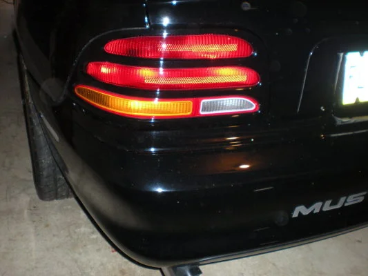

i got my new tail lights installed over the weekend. everything works like it should but now the turn signals flash wicked fast compared to before. The hazards still blink normally.
the how-to article i found said to install another light for the resistance and just leave it hang. this is such a half-assed way if you ask me. so my question is, how else can i slow down the blink rate?

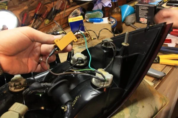

After many a probable solution and numerous resistors I've finally found a solution.
It's a .5 ohm resistor with a 50w power limit. Found them here:
Digi-Key - TMC50-.50-ND (Manufacturer - TMC50-.50)
basically soldered them into series as if it was another bulb. They get kinda hot after blinking a lot but as long as I'm mindful of that it works great. I'm talking over a minute of the turn signal being on.
Finally i can lay these export tail light to rest.

blinking for a minute, like hot enough you had to take your hand off of it. That's the whole point of a resistor is to convert electrical energy into heat energy. I could probably attach it to the body panel and use the panel as a heat sink but decided against it for now. I want to drive around with this for a while and see how it is. Right now they are hanging there at the bottom as i wanted them to have free access to open air rather than being mounted to something plastic.
Not saying this is my permanent solution but it is my solution for the foreseeable future.

I know exactly what the problem is. It was the fact that I removed a bulb from the turn signal series. The turn signal series is built such that if a bulb burns out, it blinks faster so you know it. I effectively permanently put the car into this situation with the export lights. I simulated a bulb with the resistor.
As for the heat sink, i thought about it, but it already is a surrounded by a huge hunk of aluminum. I could add more, but the size is an issue.
@eatsricejcd: export tails were used for Japan mustangs from the factory as they need to have an amber turn signal. most likely you got some cheapy altezza type ebay specials. don't know what to tell you there without pics.

Prokiller posted a photo in this thread of export taillights. In a nutshell, most other countries besides the US require the rear turn signal to be separate from the brake lights. So Ford had to make some special parts when they exported the Mustang to other countries.
The tail lights blink too fast when the system detects a bulb is burned out, it's supposed to be a warning for the driver. If you change the tail lights, and thus the number of bulbs in the tail lights, the turn signals will blink too fast. The export lights only need 1 bulb per side for the turn signals, which is less than what the system is expecting. What Prokiller is doing is fooling the system into thinking that all the bulbs are there.
