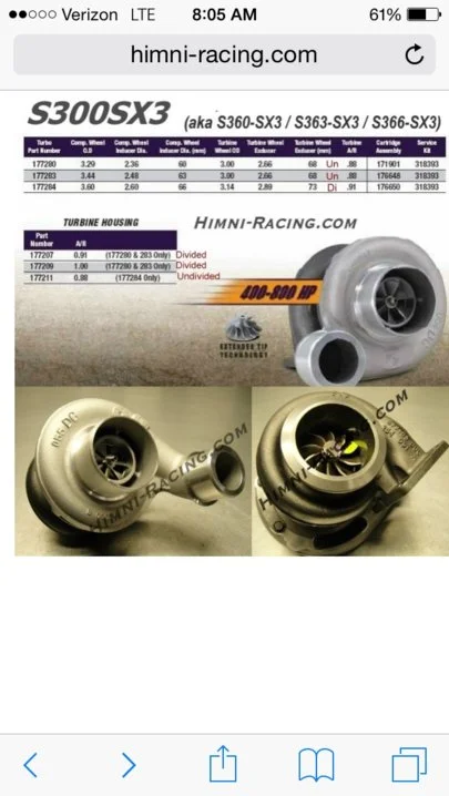

I decided to decline on the offers of the twins and now gonna focus on going the single route I spent all weekend both researching turbos looking at maps which is monotonous let me tell you. I've talked to a few companies on what they recommend. Precision tells me to go with a pt7175. A dealer of borg Warner has given me the option of going with a s300sx3-66. I'm leaning towards the Borg Warner mainly because I can get it in a 90* compressor housing. The only reason I would want that is because I have smooth aprons and would want this to be as clean as possible. Get a set of headers where the turbo is on the drivers side. Hopefully I will only have to make one hole going into the bay for the piping after the intercooler. Here is a picture of the borg Warner now i don't know if precision offers this for theirs or not haven't dug that far yet.
