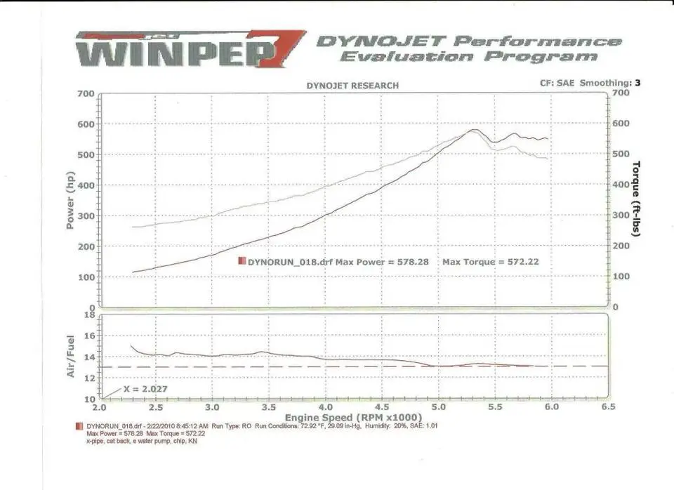

9.3PSI run

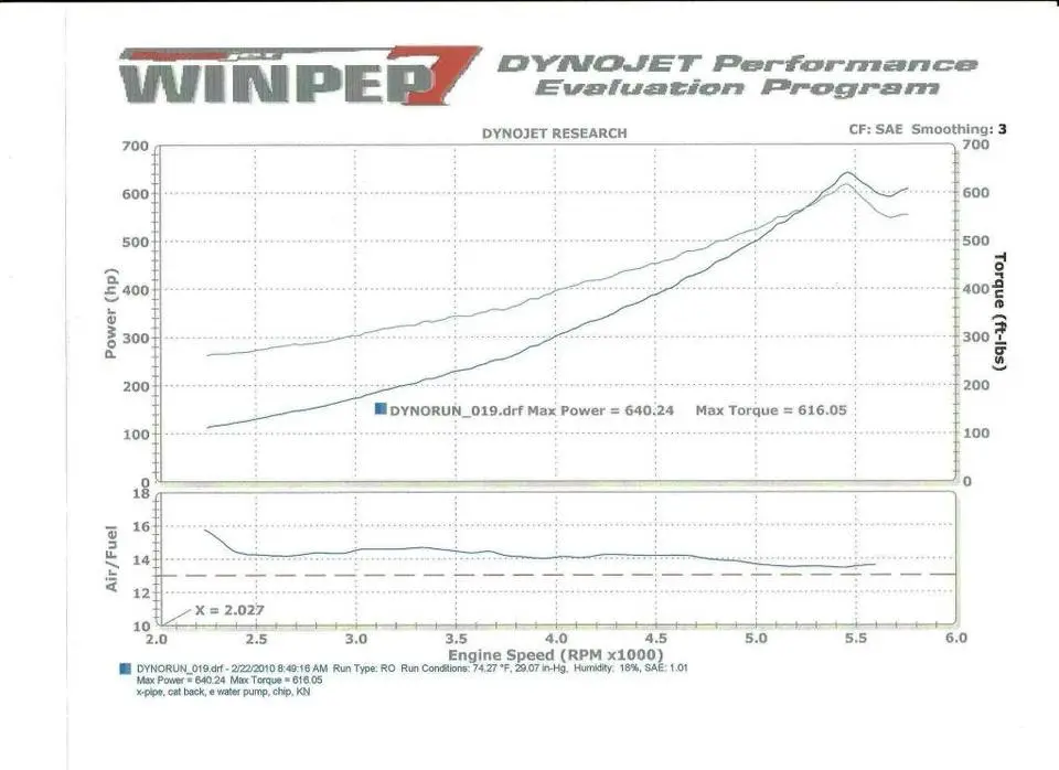

12.6PSI or so peak.

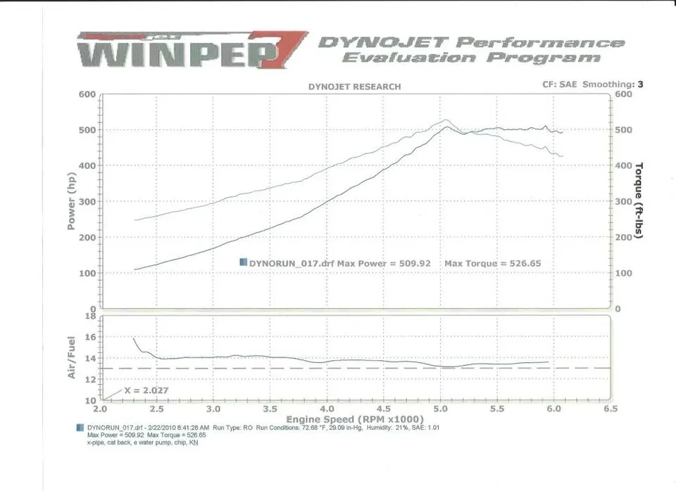

and the last one it peaked @ 14.5PSI then dropped to 13.5 as I didnt have the boost setpoint ajusted correctly.

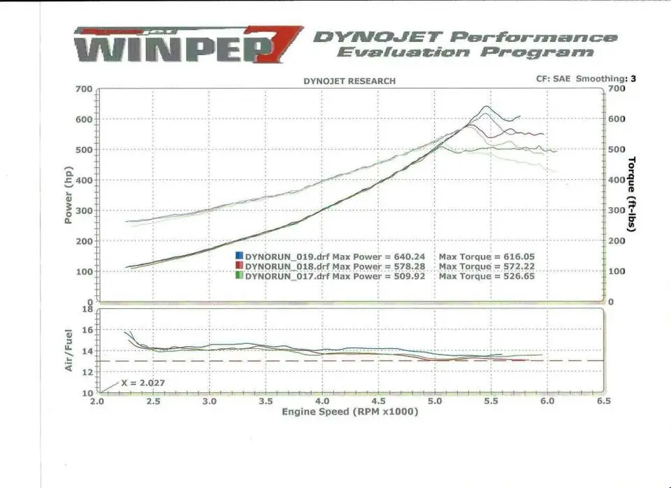

Oh and the combined runs.
Did I mention that this was all done on a STOCK SHORTBLOCK/STOCK HEADS, 4.6L 2V? :D
I have videos of the runs and pictures of the exhaust if anyone is intersted. Also please do not pay attention to the A/F...its off. My wideband reads 11.0-11.3 on the topend...I have it stair stepping down as boost rises.

I just want to make sure I am reading 640 and 615 rwhp/tq on a BONE STOCK 2v bottom end. Pretty sure I am, but I am shocked, haha.
