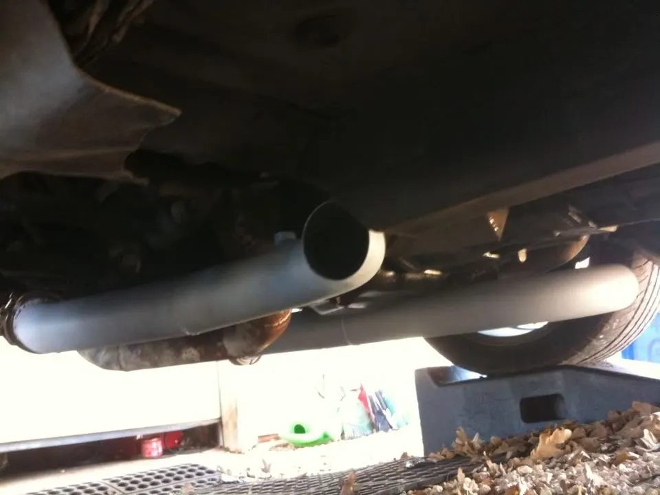

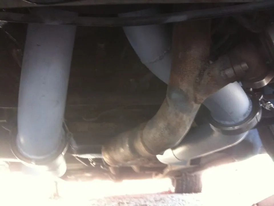

Ok here are the pics of the downpipe I just made before the dyno.
Dont mind the rust on the uppipe haha...car had been setting a while and I havnt got around to painting them again.
Overall I gained a good amount of ground clearance and no it was NOT easy to route the pipes like that lol. I think that pic was taken before it was fully bolted up, but the pipes are level with eachother :)

I like your exhaust setup a lot. You have no mufflers and it just exits underneath the car like that? When my cutout is open on the 88, it dumps towards the ground and is pretty dang loud. I'm always thinking if I point the exhaust out the side, it would be much quieter. Did you find that to be true?
Yes I bought the car brand new :) had 8 miles on it and had a driver bring it down to Austin...168 miles when I signed the papers.
I did notice that it's quiter everywhere except right where they exit haha. I had ran it with open downpipes for a while before rebuilding the downpipes and now it's def quieter.
The other downpipes just exited straight towards the back...they stopped at about the k member haha.
