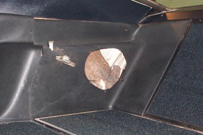

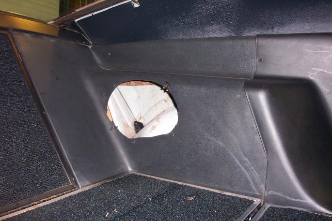

2 of the primary parts that I'm still searching for (since I purchased the car) are the rear corner plastic pieces, but it seams that all the 71-72 sportroofs that I come across have the rear shelf and no trap door, thus they don't use these corner pieces.
Left Rear Interior
Right Rear Interior

Oh crud! Those are some speaker holes there.... maybe you should fill them in with the PO's skin? (
Seriously, though... there is a wrecking yard near me that I recall had a '73 mach (less front end to the windshield... it looked like it HURT) I'll check later this week and see what it's got- if it is still there. (I seem to think it was Ginger interior)
I'll get back later.

Yeah, looks like the PO discovered the hard way that the wheel wells don't allow enough room to mount speakers there. Kind of reminds me of my friend who mounted speakers above the arm rests on the doors of his 72 Coupe only to discover later that he couldn't open the windows more than a few inches .
Cool!! Any color works for me. I'll just paint them black. All the junk yards around here have long since gotten rid of their classics before they turned into classic New England rust.
