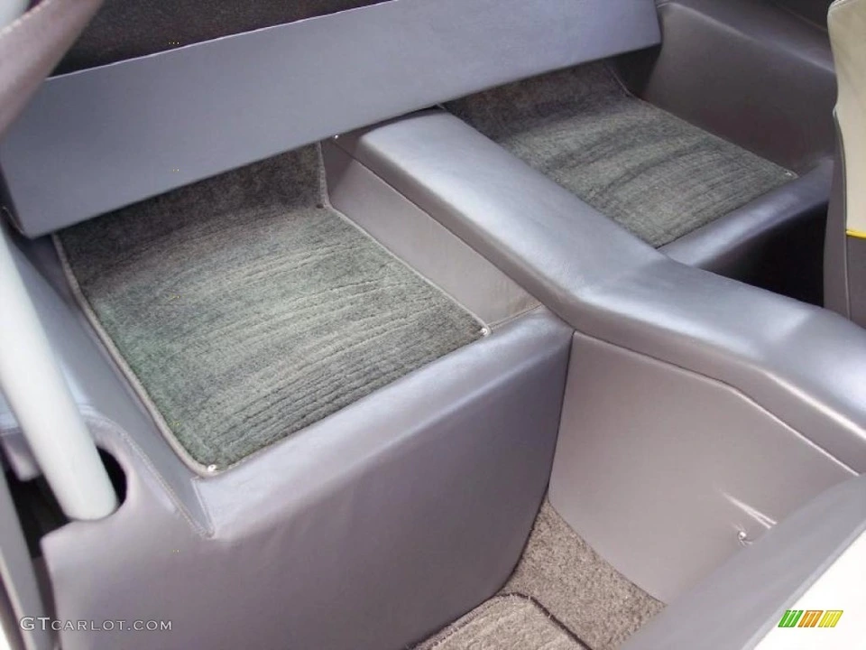

IF it is a convert., In a recent Mustang magazine was a model that came from the second factory as a two seat model. I think it was a special Saleen model for one year? If I see it I will post a link. Anyway, I bet there is a fiberglass tonneau cover for this project. It would be slick with the rear seat delete or a custom cabinet/stereo box.

The SSC Saleens were two seaters with a custom rear delete. There was a guy building the rear boxes but with a little work a custom one wouldnt be that hard.
