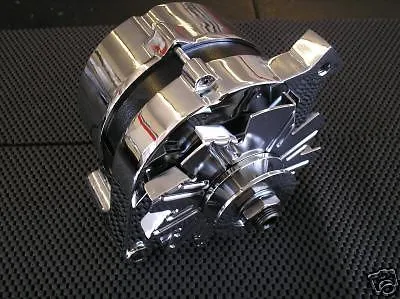

I got one of these from eBay (3-wire as opposed to a 1-wire)
I sent a message to the seller asking if it had an internal regulator. If indeed it does I can junk the old voltage regulator correct?

toddman0025 said:
but my stock voltage regulator is rated at ~60A - that's a problem isn't it?
Regulators arent rated, that BS! However there IS a SMALL chance that the upgrade could make the points in a mechanical regulator stick, but I doubt it. If you want, an electronic regualtor is $12 from autozone...no worries then. Besides its not like the regulator sees much, if any current.
