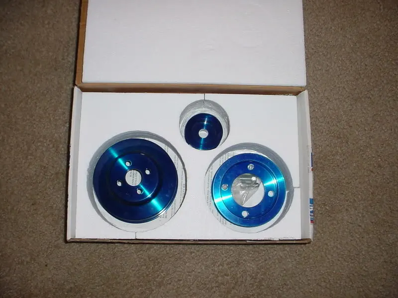

I am looking to finally ditch my stock pulleys and go with a set of Aluminum Blue Anodized pulleys. But I have a question about the 25% under drive. Will this cause me to have any alternator charging or cooling issues with my setup? I do have a Hypertech thermostate 160 degree I believe is the rating in it now. I also have my fans wired to a relay and a switch and do not have any cooling issues as of now. I have never seen the car raise really above the 190 mark when warmed up. So I just want to be darn sure before I put these on my car. Thanks for any suggestions :D
If you have charging or cooling issues after a pulley swap it's most likely the problem was already there just not noticeable. If both are up to par there should be no issues after the swap. I've had my ASP pulleys going on 3 yrs or more and zero issues thus far. Hell I had more cooling issues when I lost my air dam under the bumper then the pulley swap.
