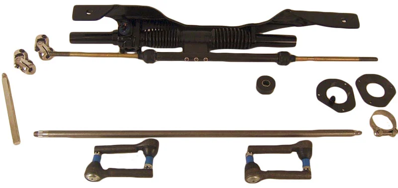

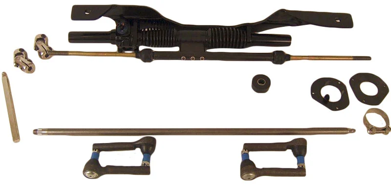

The unit I have uses the new "Center takeoff design" that connects the tie rods to the center of the rack.
Here is a pic I found on line that looks like my 65 rack.
Note where the splined input shaft is located on both, this was the issue with the steering shaft and headers on the original.
The older design used this style with the tie rods coming out of the ends, as you can see it is a totally different design.

I installed the early rack several years ago. I fought the u joint bind for several hours before it worked smoothly, then had to modify 1 tube on the headers. Looking at the picture of the late design, there should be little if any problems with u joints as the pinion is much closer to where the original box was mounted. It appears to be a take off from a GM J car rack, just not power assisted
