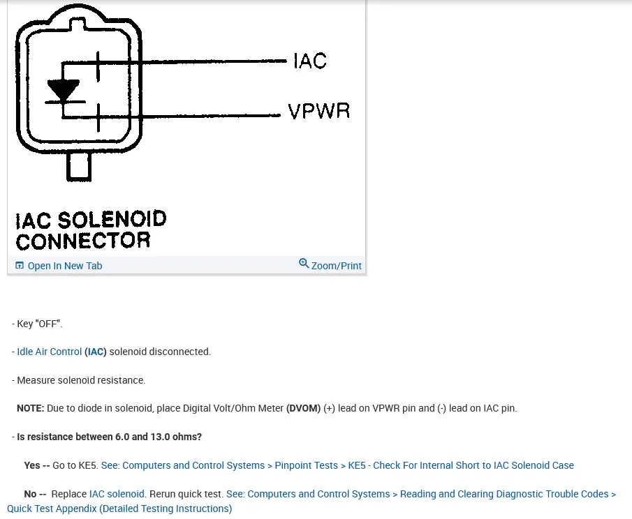

Fixed the issue. Smoke test didn't really reveal anything on the EGR or IAC side, but the cabin looked like I was hotboxing, smoke was coming in through the brake booster. I had access to my buddy's AllData account, too, which lead me through a diagnostic tree to check IAC resistance. Both the IACs I had were out of spec at ~17 ohms. Oreilly's had one, I checked theirs and it read ~11 ohms. Put it in, went through the reset procedure for base idle, and no more rev hang.
Now on to the brake booster.....:rolleyes:
Screenshot_2021-05-01 KE4 - Measure IAC Solenoid Resistance (Computers and Control Systems) -...webp
