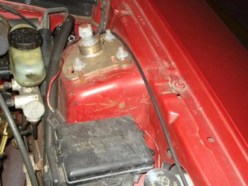

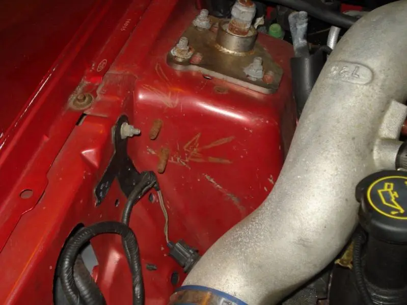

oh AND it has some weird bolts that obviously look like that have been put there any ideas to what they were for??

well the only thing I really see there that hasn't been done is your front o2 sensors. Also maybe you're injectors are gunked up.
as for those bolts...they're studs of some sort for something that was previously mounted (obviously) not real sure what would go over there though...
