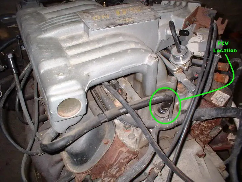

There is a sensor directly in the center of the lower intake manifold at the fire wall that I'm not sure what it is, it's all melted, I don't know if it was vacuum or electric. Can someone tell what this sensor is for and what it hooks up to.

Sounds like that's the PCV valve. Tjis is a pic yanked of the internet of the back of our engines.

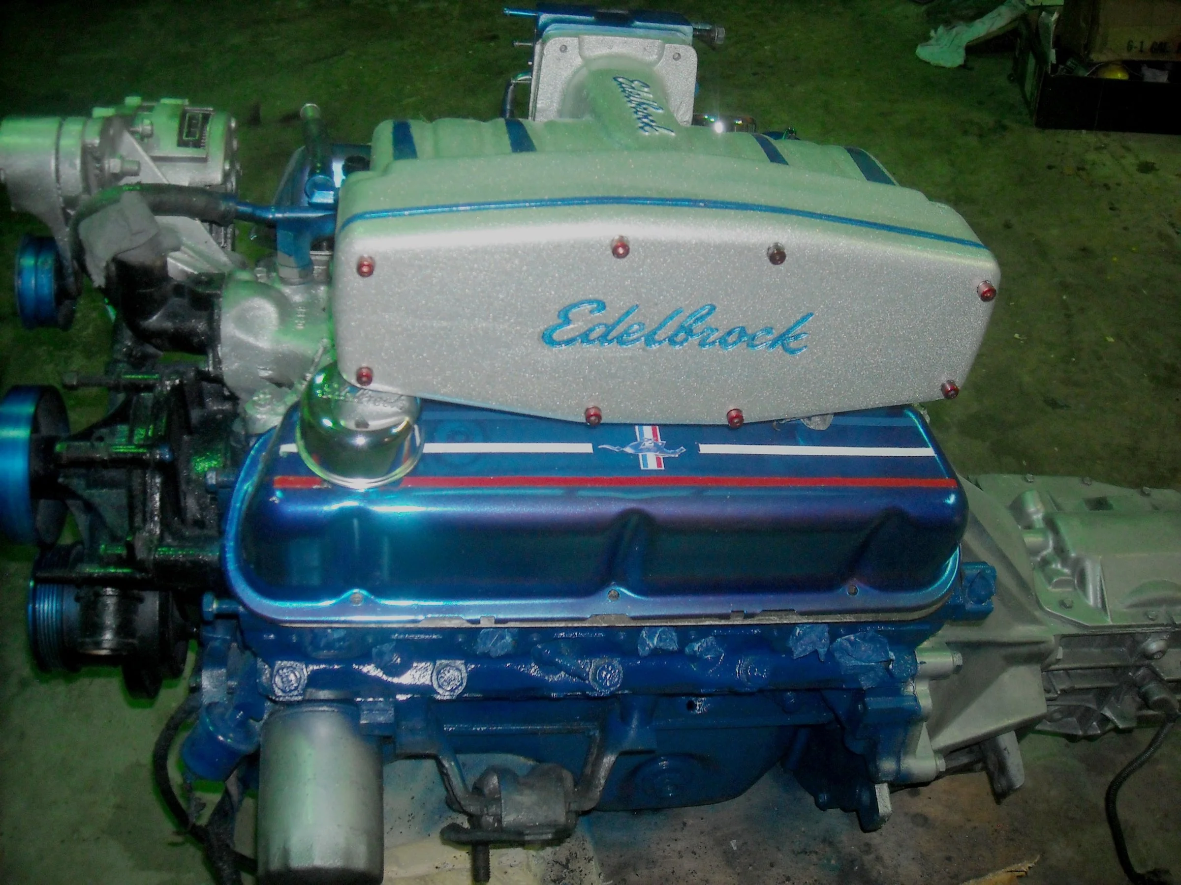

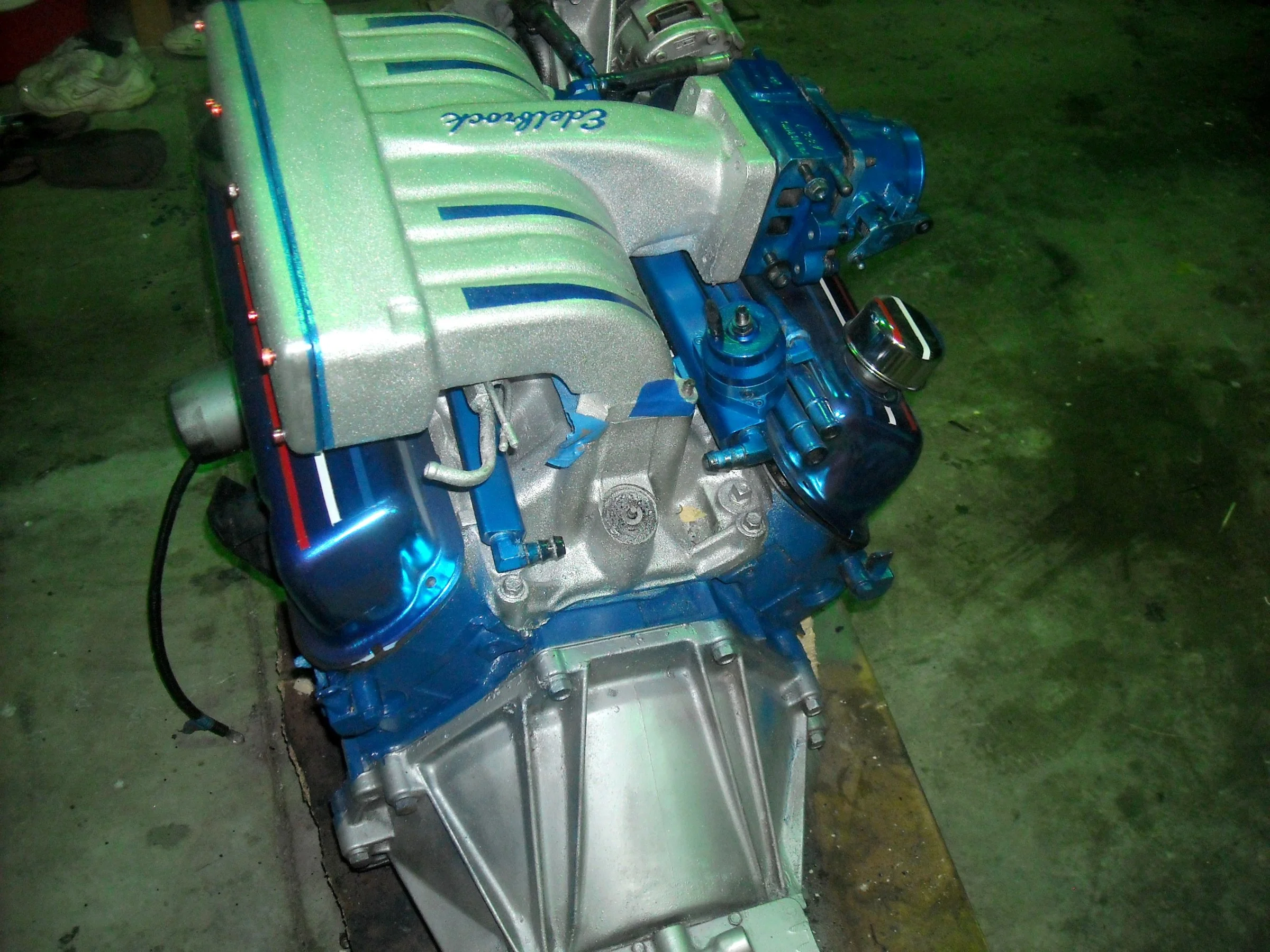

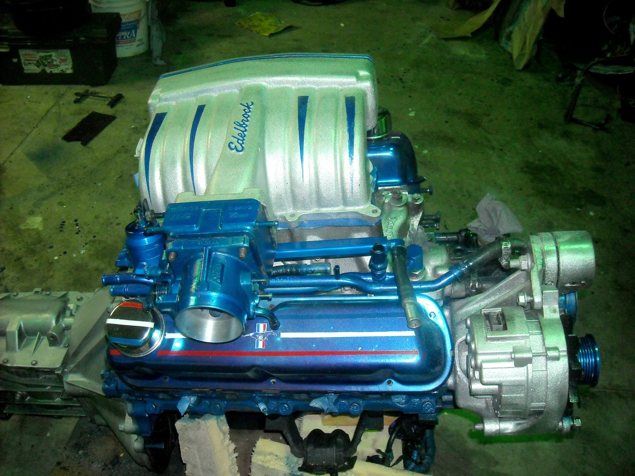

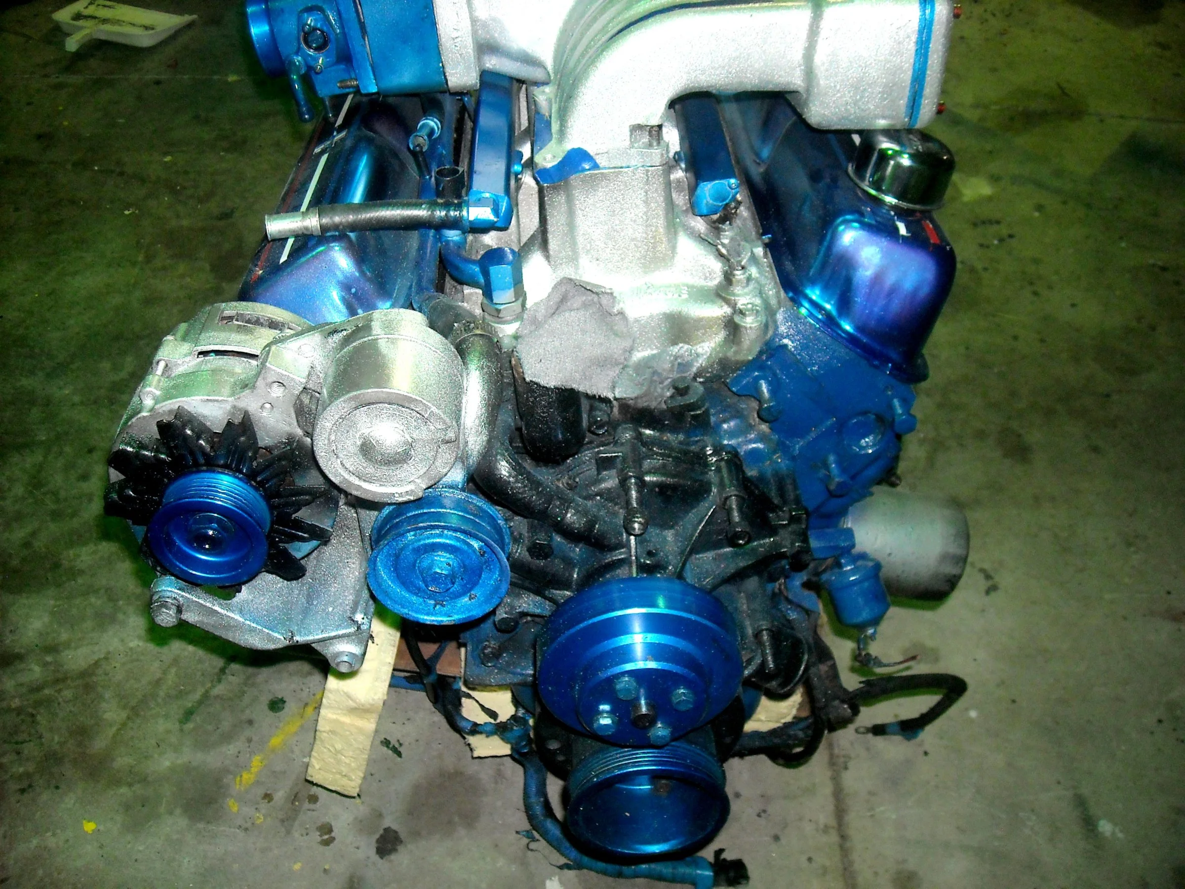

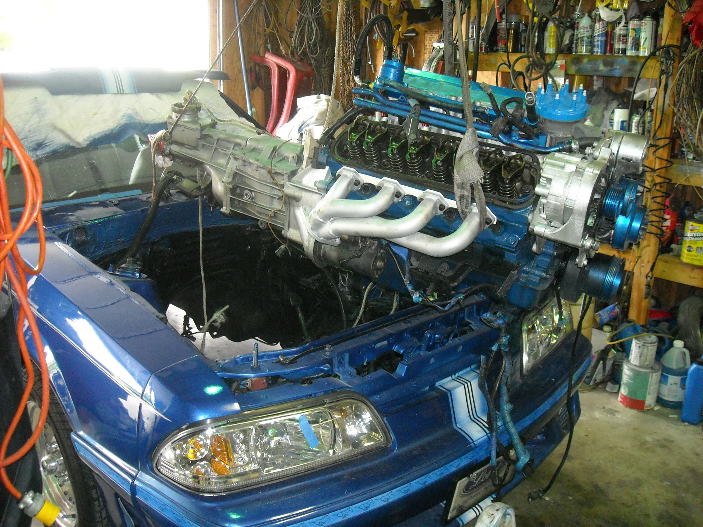

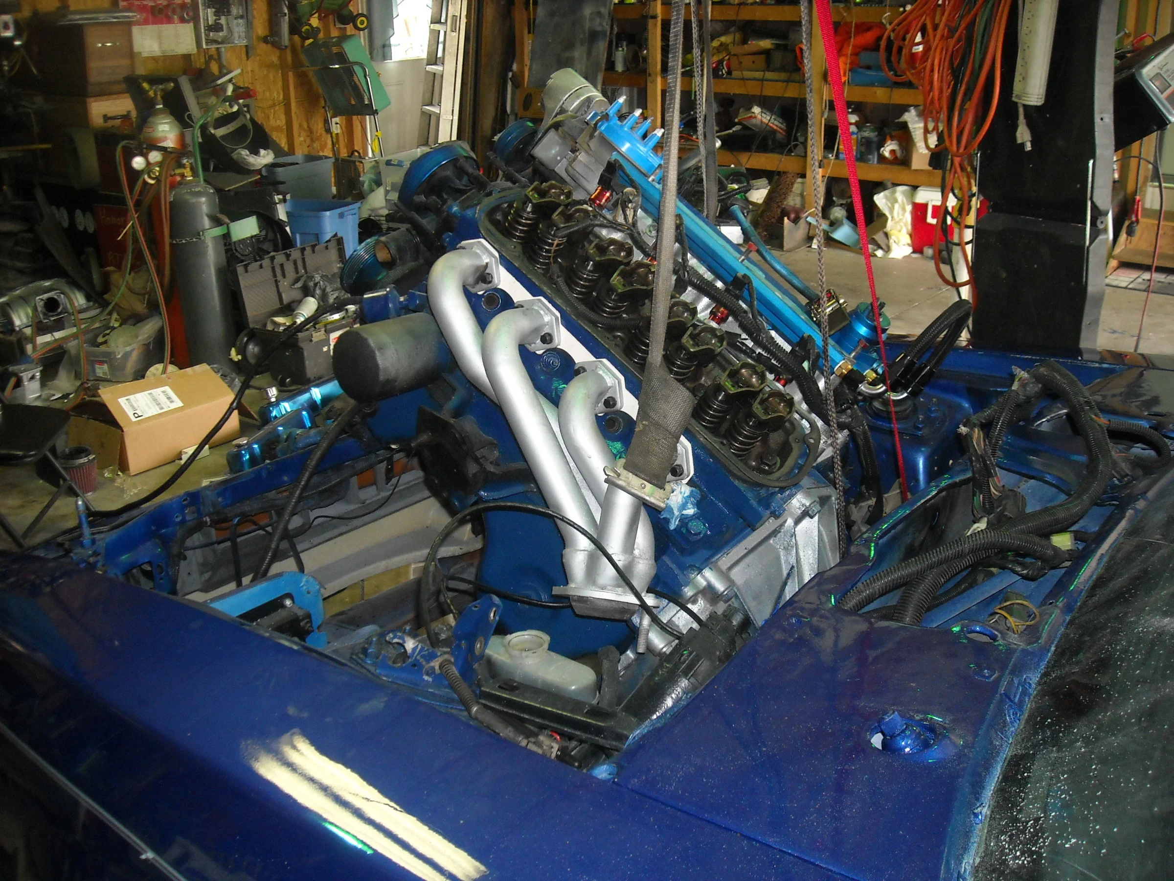

ok, so I did a little cleaning up and found my camera on a shelf with a shop rag laid over it, go figure.
so here is the progress I have made on the engine, everything is mocked up and just sitting on the engine.

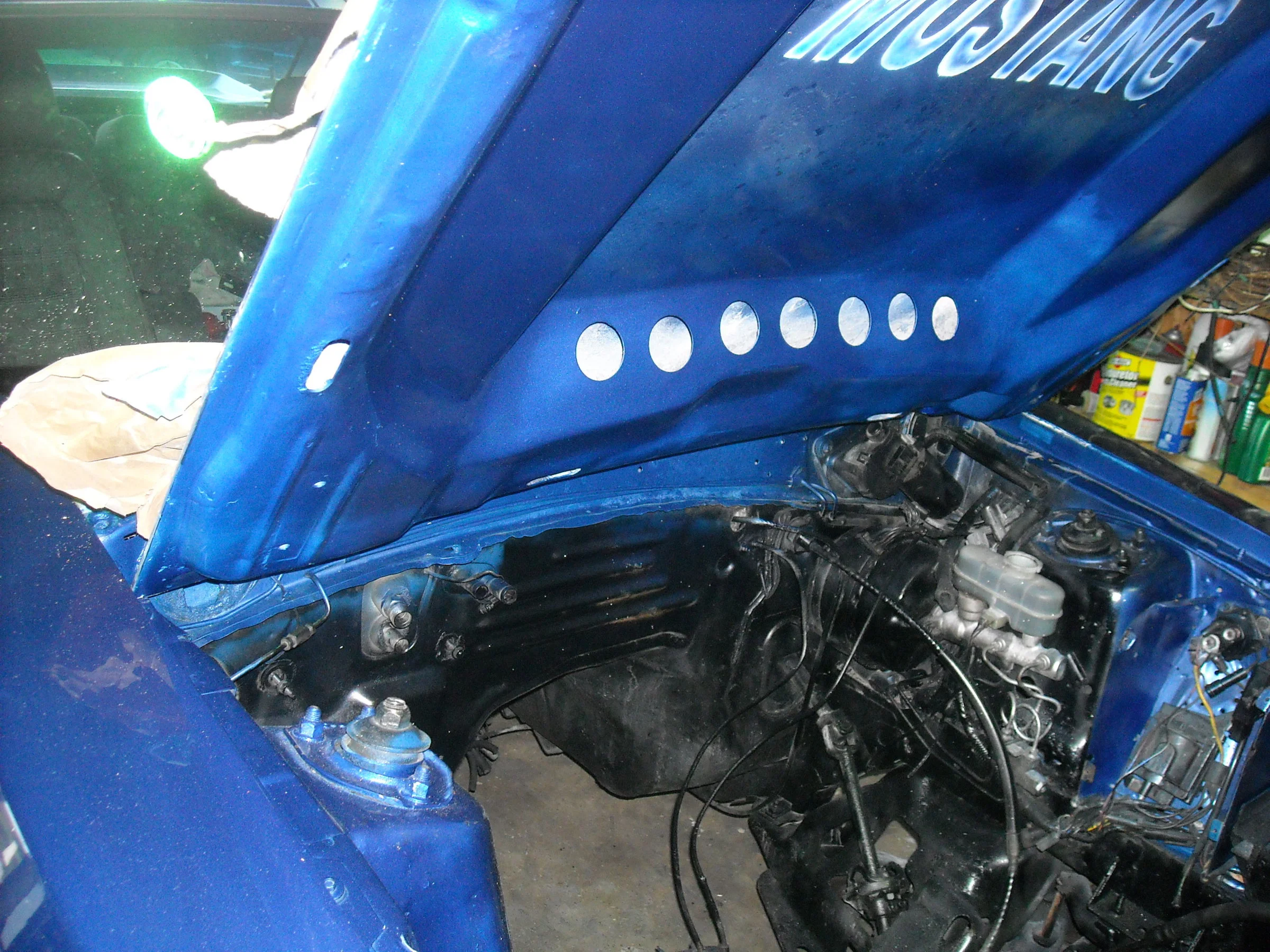

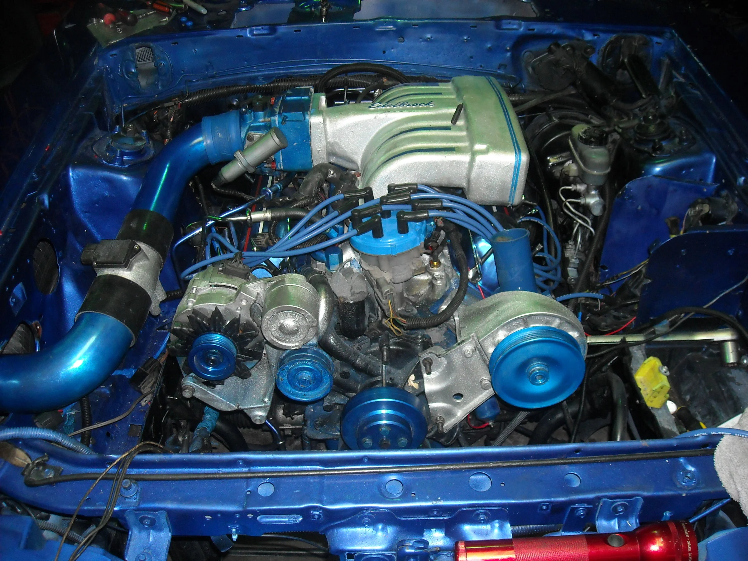

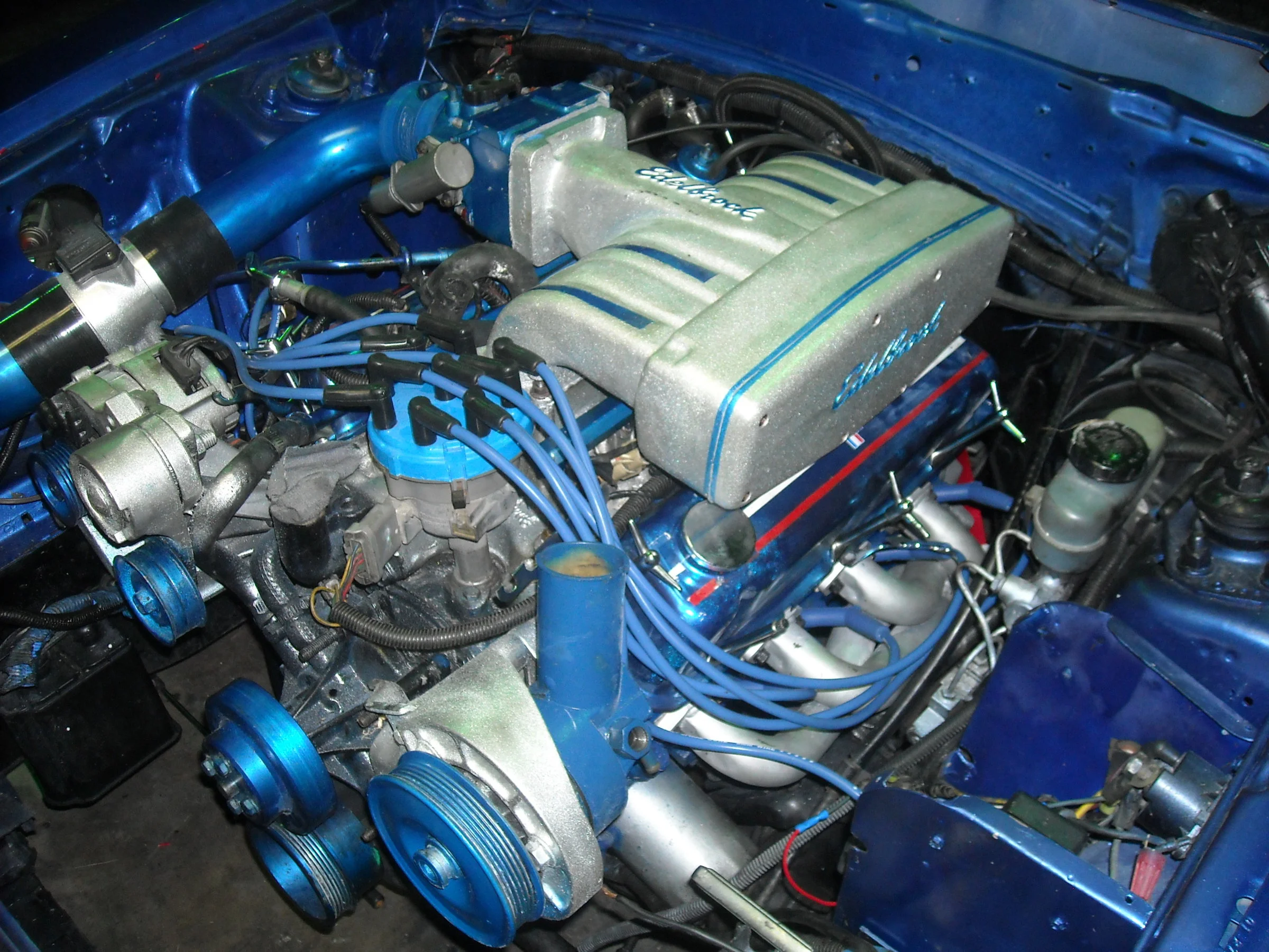

Well, finally finished the underside of the hood and it came out alright paint matched ok. Ordered most of the remaining parts needed. Installed new 24# 4 hole injectors and fuel rails. Started swap of new engine wiring harness, still need to do the MAF wiring swap but it looks pretty straight forward. Just waiting for a rainy day and I'll drop the motor back in.

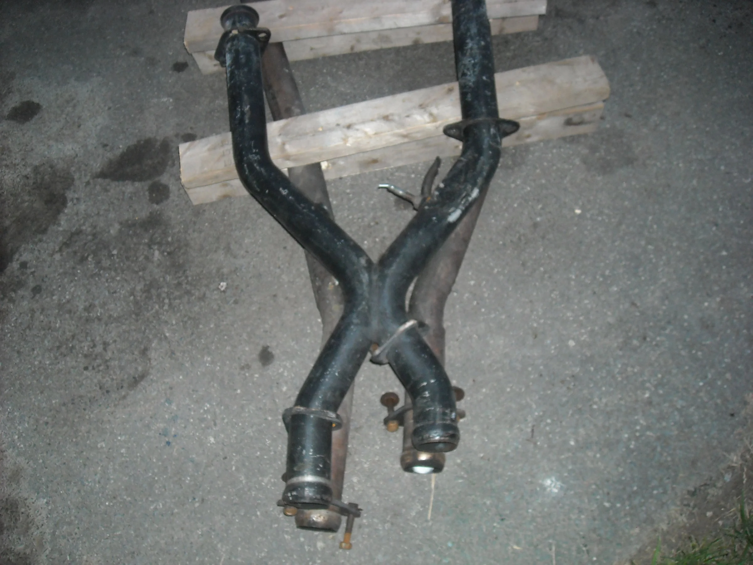

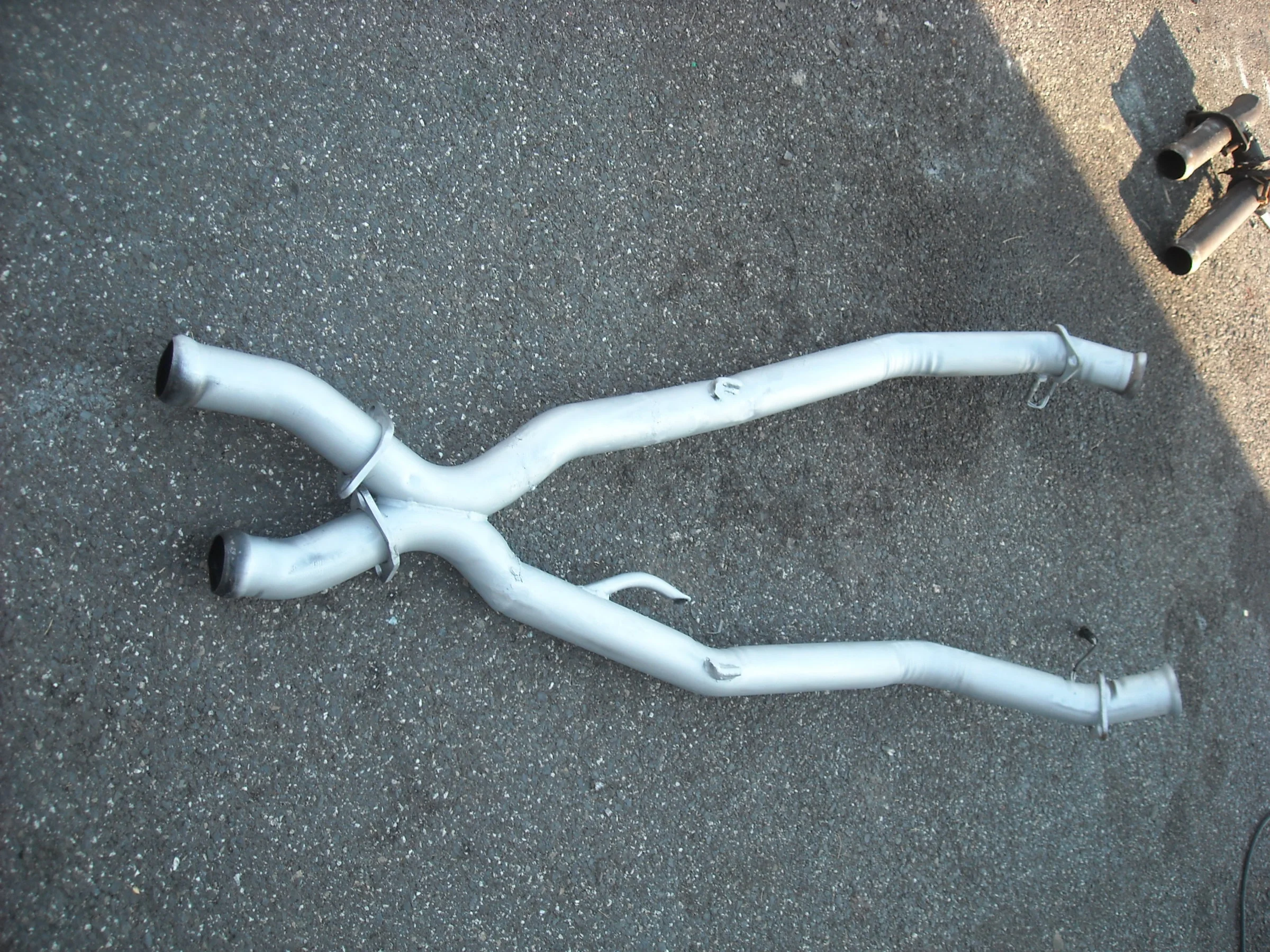

So I'm trying to multitask here with the paint, motor and now some exhaust work.

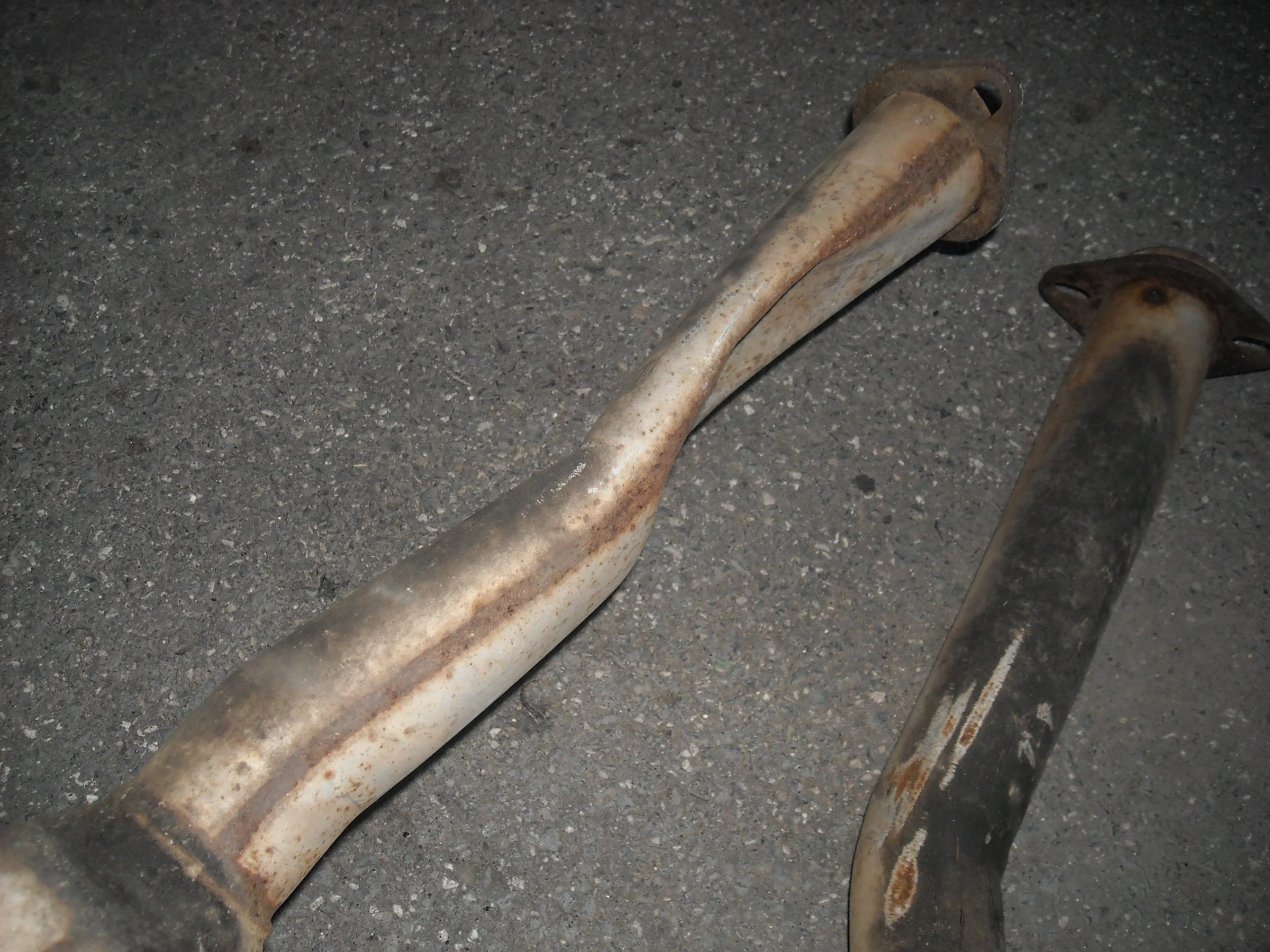

I never had tailpipes on the car, just some temp. flex pipe to get it out from under the car, PO chopped them off behind the mufflers.

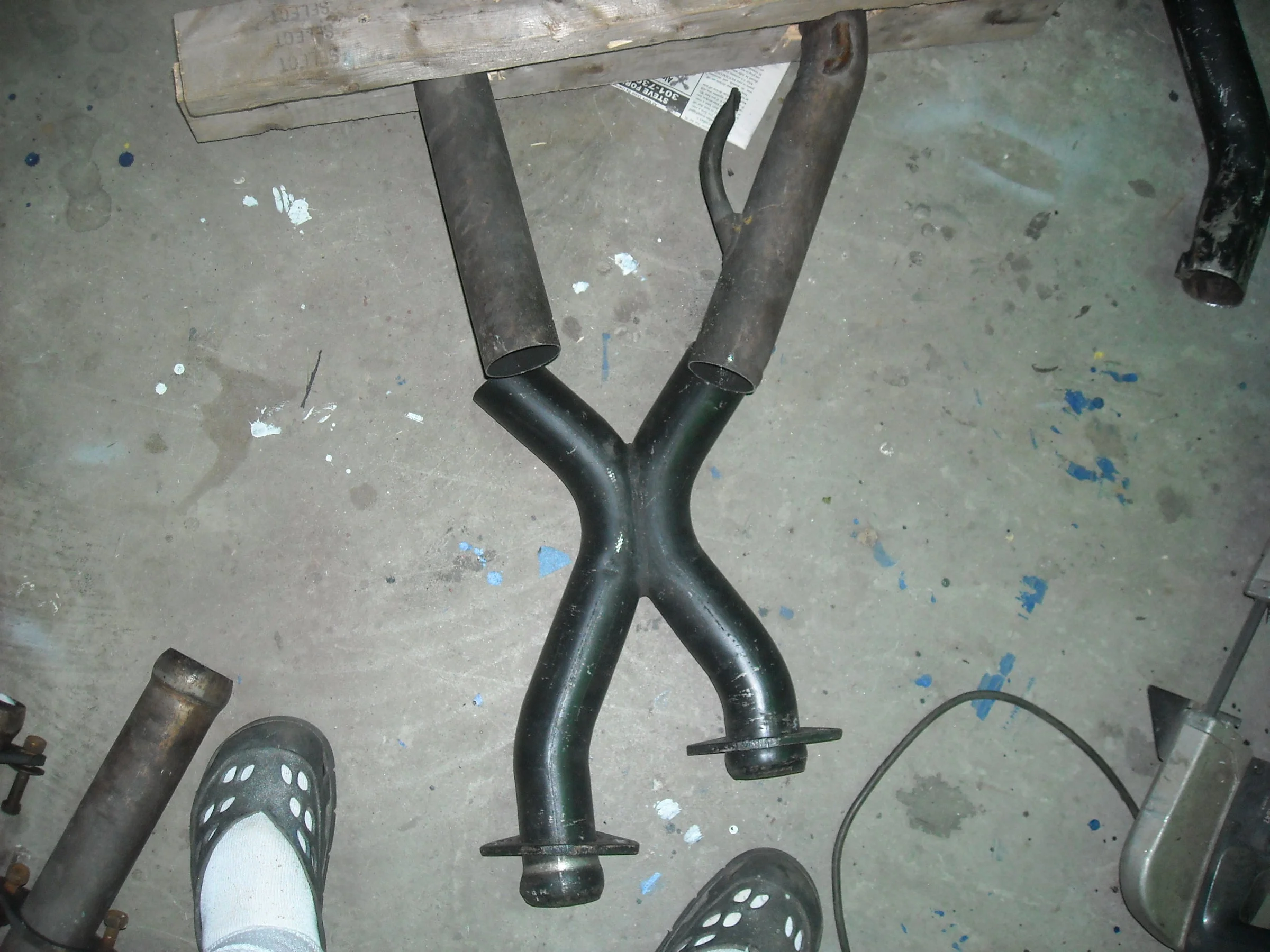

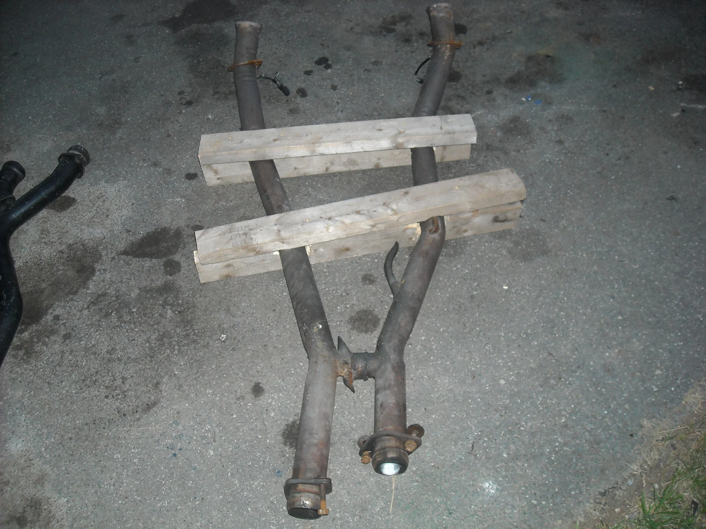

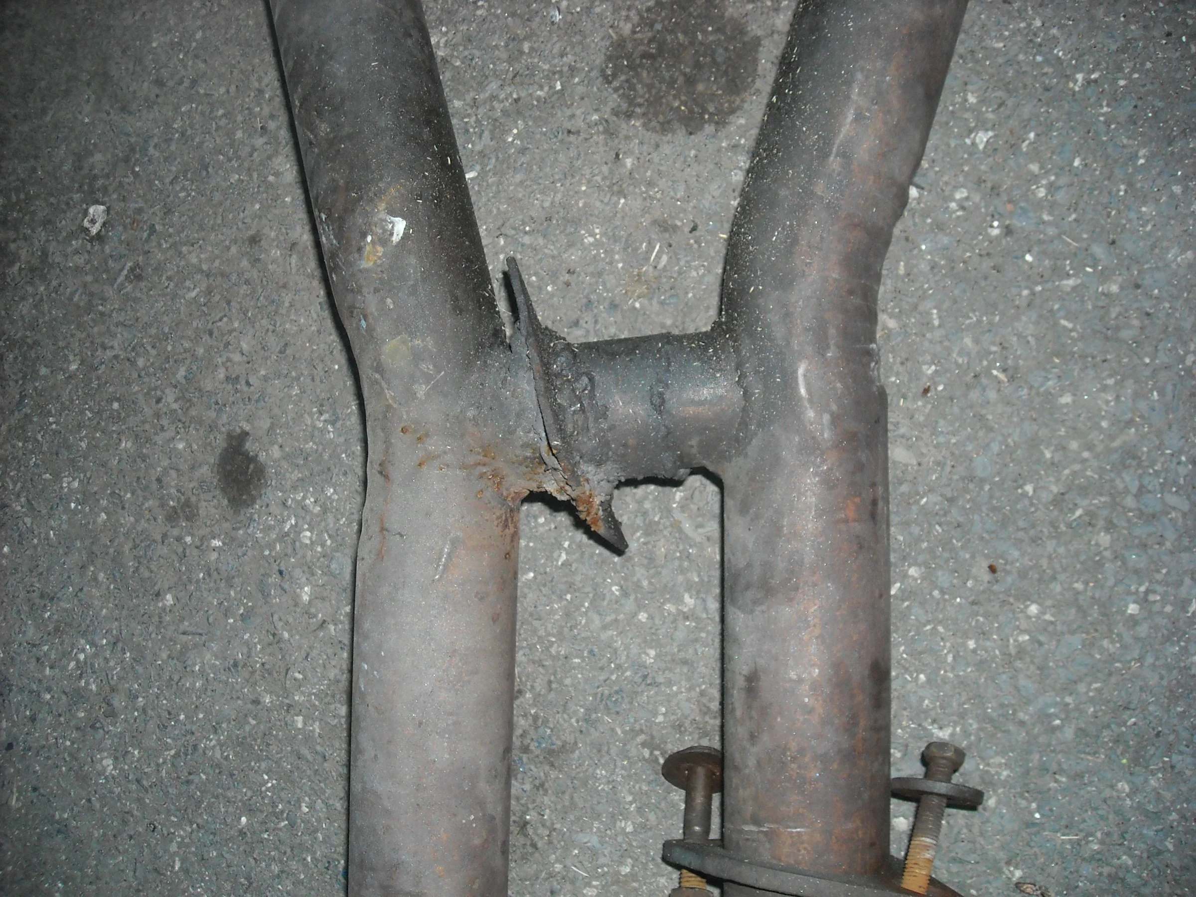

So I picked up a used exhaust system with tp and mufflers this winter. The car has 2 1/2" pipes on it with an "h" pipe (if you want to call it that) but I picked up a badly abused x pipe at Carlisle for only $10, so I grafted it in after some serious work on it.
Someone had split the H pipe and inserted a blank plate in it to block it off ??? Not only was the weld nasty looking but I guess they didn't own a grinder either.
I made a little jig to hold the pipes in place so that when I cut out the H piece everything stayed in the correct orientation, it worked out well.

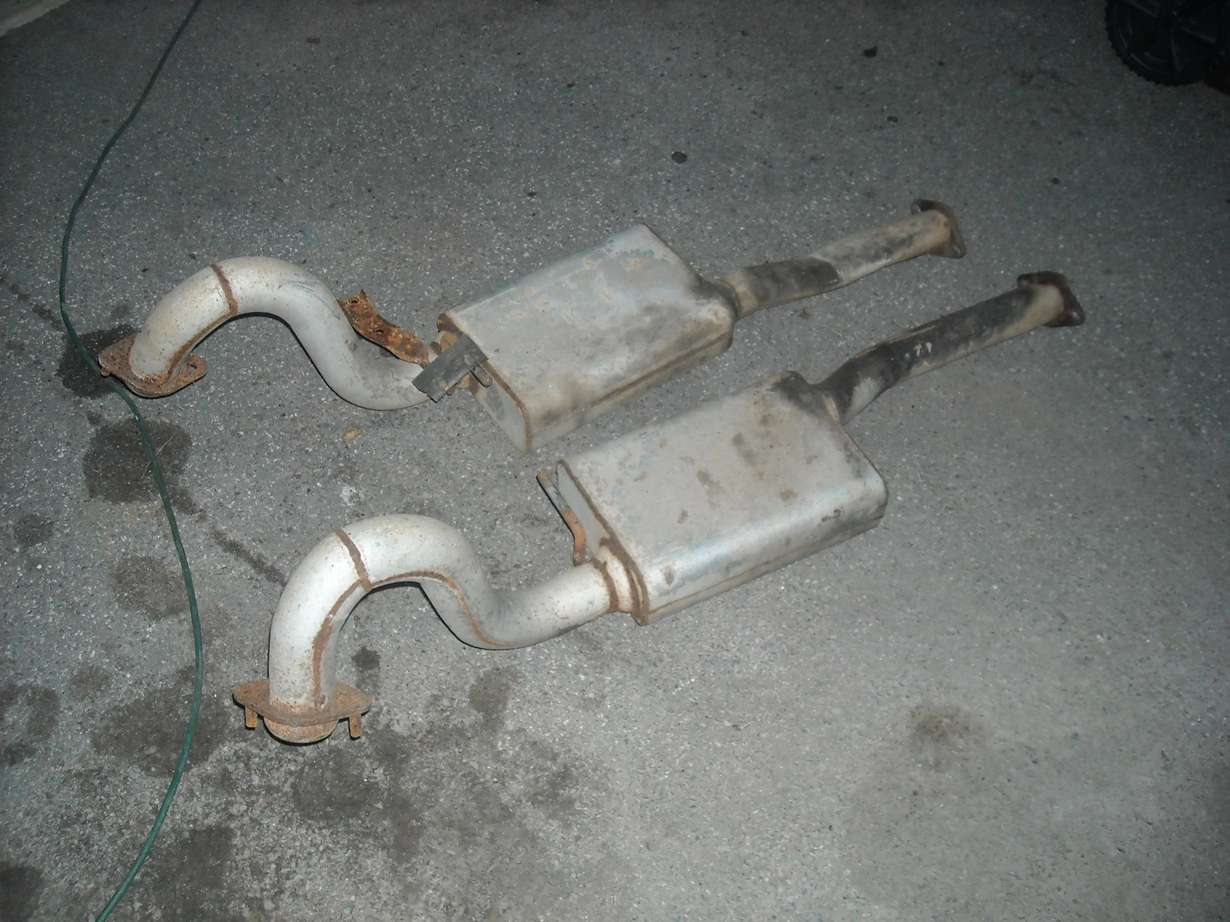

The original mufflers were flow masters and they sounded pretty good but these new pipe have a big square welded muffler without any name on they.
Does anybody recognize these. I don't know what they might sound like but they are pretty open inside. We"ll see.
I bet that blocking plate helped it to sound more like a dump truck. Pretty nasty.
Good job fixing it though.
I'm clueless concerning your mufflers. (And a lot of other things as well, different thread there though)
I don't know how it would have sounded without the blocking plate, I know everyone recommends either an x or and h. I think they came with an h but seems the x make a few more ponies and torque??
From what I can see on the internet this muffler resemble the spintech mufflers, not sure be sure looks like them. Good reviews about the deep tone so we'll see.

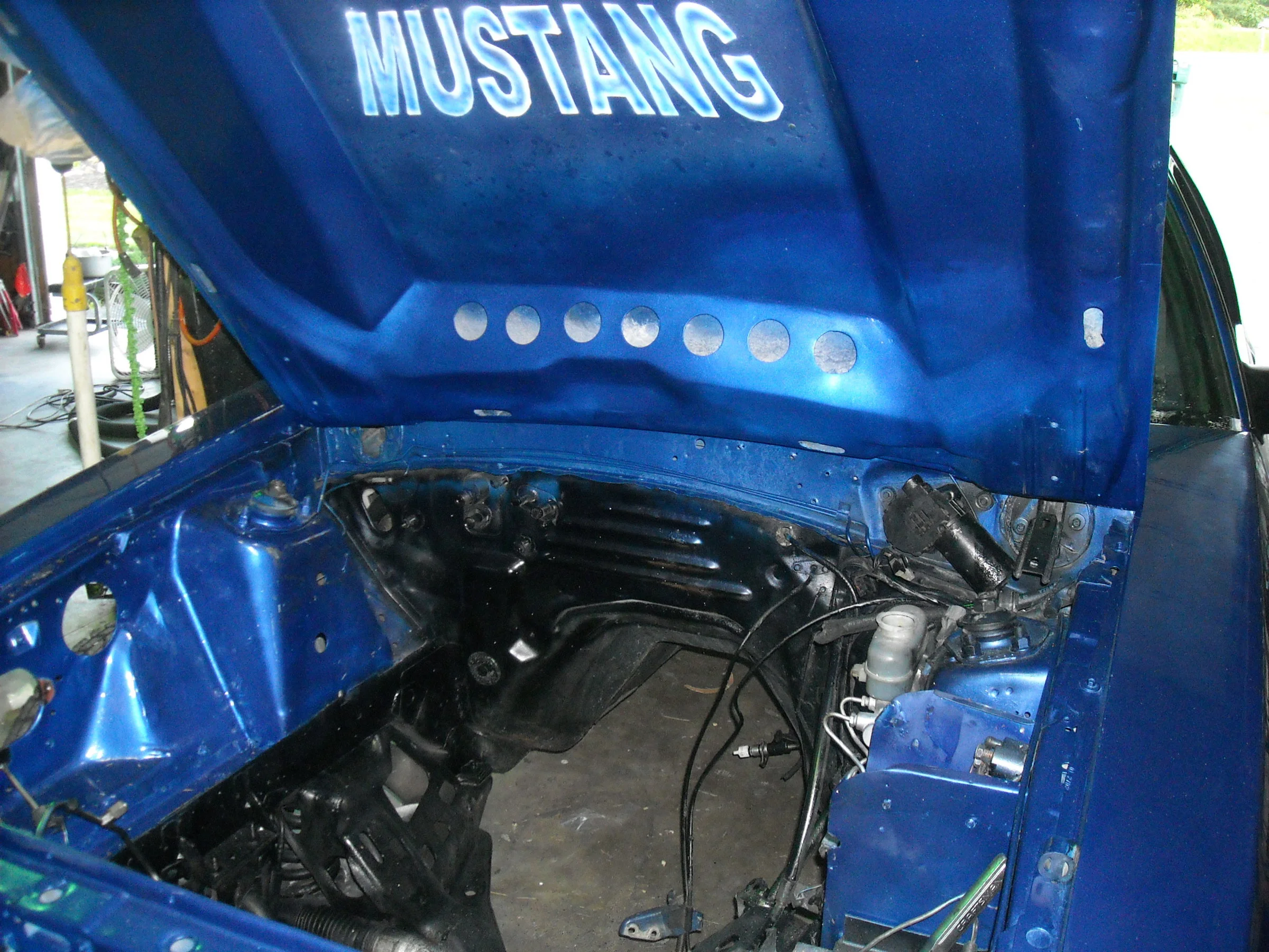

Finished painting the hood , it didn't come out quite as nice as I would have liked, (better first time) but I didn't have quite enough paint to start all over and repaint the whole hood. I'm not a painter and trying to blend this all in is not as easy as painting the whole hood.
Going to start putting the motor in tomorrow and hopefully should be cruising Sat. night YAHOOOOOOOOO!!!!!!!!!! can you smell the rubber????
Didn't quite get to work on car all day, some parts running and such. Had a hard time finding those little molded heater hoses that go to the metal pipes along the intake manifold.
but she's in there alright, just need to do the radiator, finish up some lose end wiring and do all the stuff under the car, trans. support, speedo, drive shaft etc. Should be ready to fire up Monday ??
I've waited this long a couple extra day won't hurt and I don't move quite as fast as I used to.
