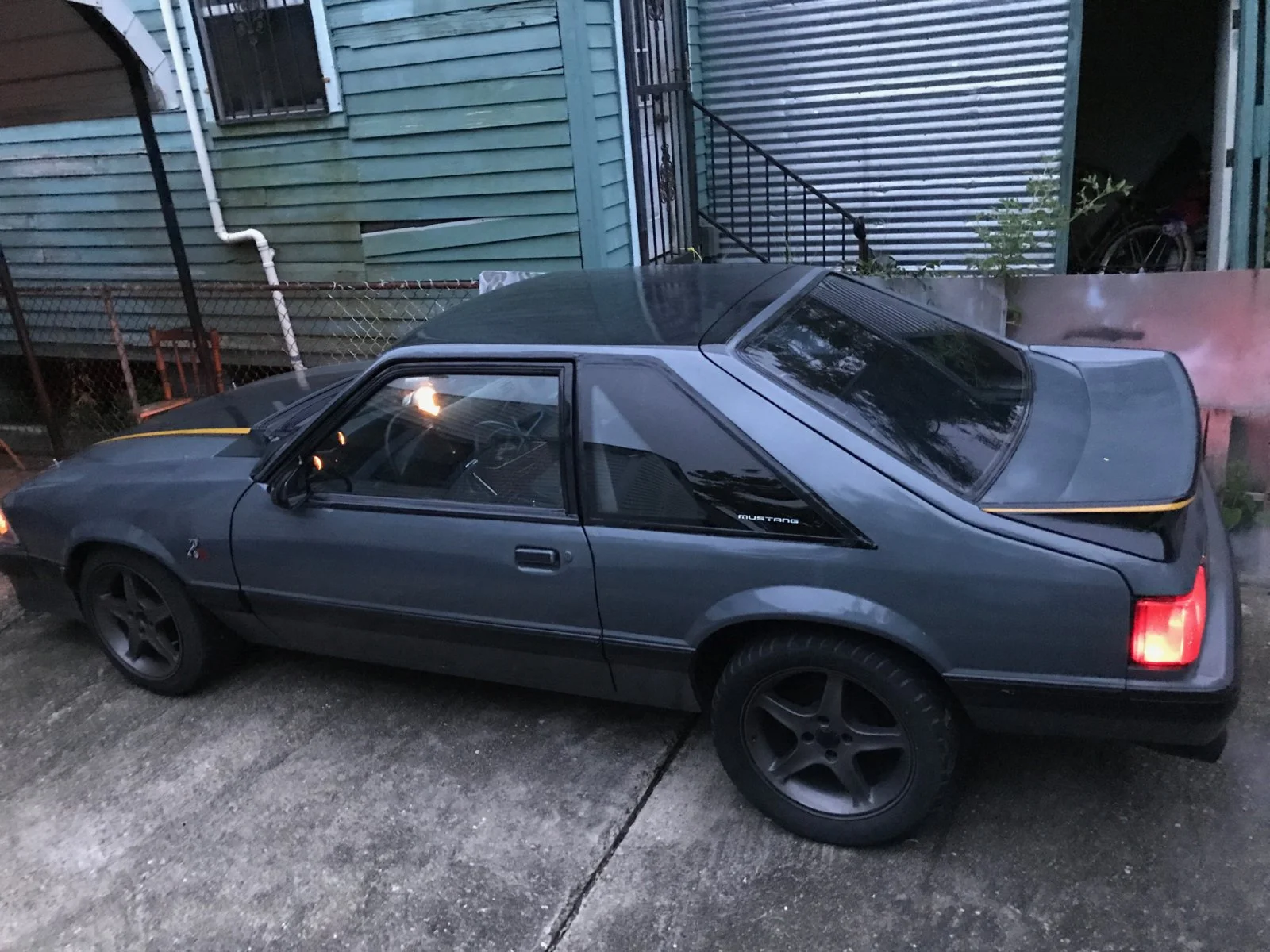

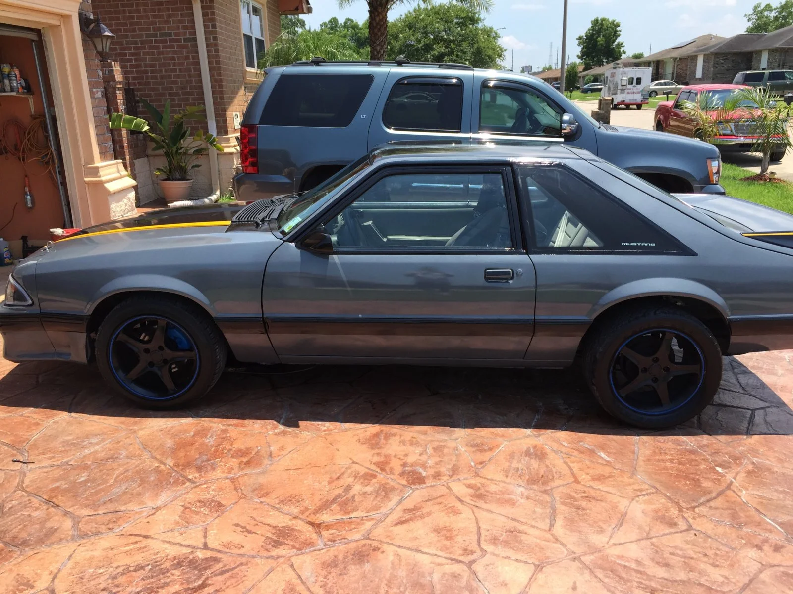

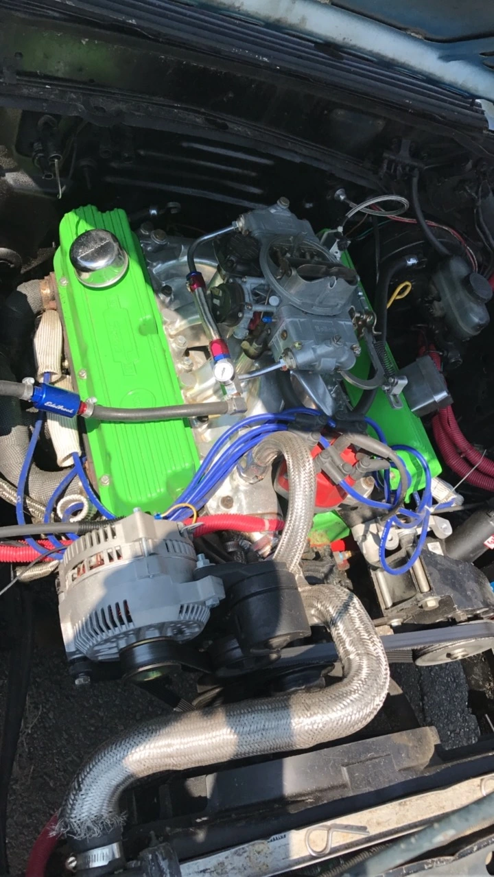

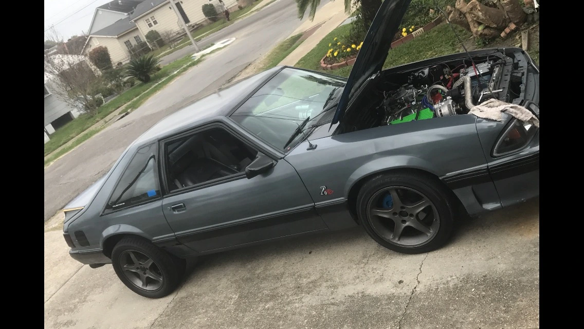

I’ll include a couple of pictures. The pictures make it look clean, but we all know pictures and real life tell very different stories:

Looks like a nice car for $1000, assuming the frame rails and floors aren’t full of rust. Rebuilding the 351 shouldnt be more than $1000/1500 if you reuse the existing heads, cam, intake, etc.

Car looks to be in pretty good shape. I’d say it’s worth $1000...... but it would be a shame to see one like that parted out. It deserves to live!

They will be worth more and more money in the future....but is difficult to even break even if the decision is to sell. To get a decent engine in there and other things it may need may set you back 5k...if done cheaply ( but not junk yard cheap ). I'm talking about fluids changes, brakes, suspension stuff, engine, and minor other stuff that may pop up in the process. There is a chance that this car may only need a new engine...but that chance is slim.
There are options with engines. The easiest would be a new short block and bolt on the factory heads and intake yourself. The heads will still need to go to a machine shop though. At that point a set of JY explorer heads would be the same machining bill. The best would be to install a complete assembled engine and bolt the intake on and fire it up. My local machine shop would completely rebuild a mustang engine for between 1600 and 2200 depending on how much it needed replaced. Gave a 1yr 12k warranty.
