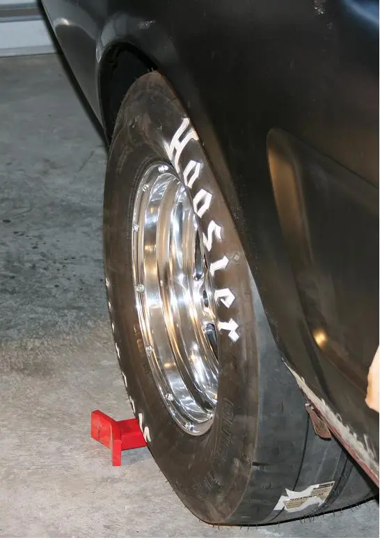

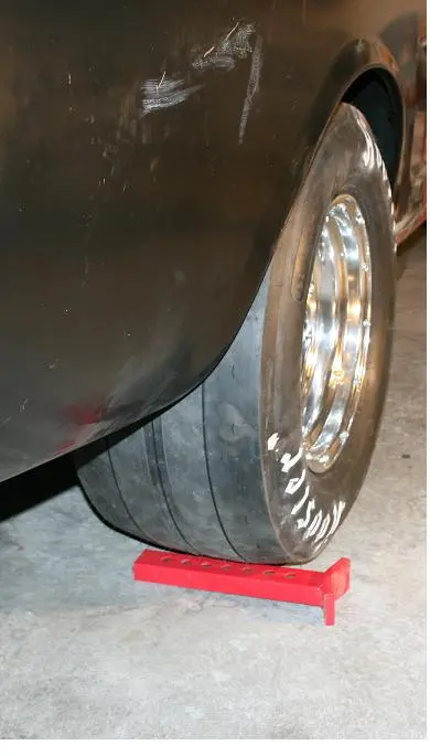

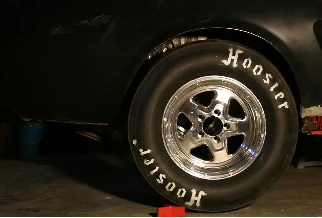

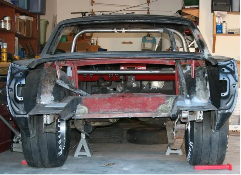

66 coupe w/ 67 outer wheel wells (quarters stretched over), frame notched with inner well moved to frame. The tires are 13.5X28 on a 15X10 rim. The car should sit a little lower when I am done (that will look better). The tires stick out a tad up front, but otherwise fit well. I have about .5-.75 inch between the inner wheel well and tire.
also as you can tell the leaf springs are moved in.
