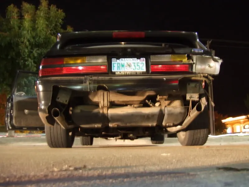

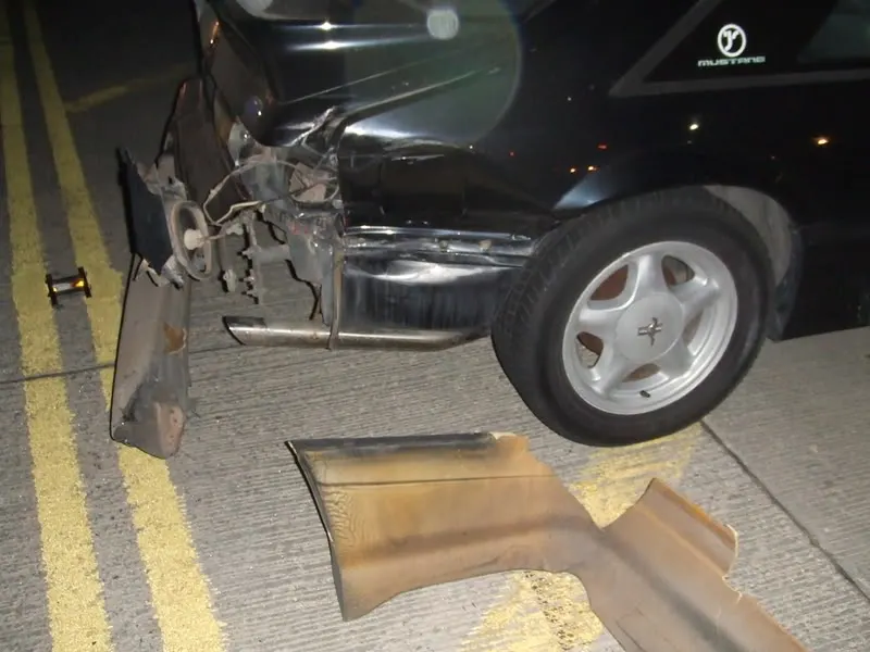

if any of you remember, i got hit on halloween. i got $3500 from the lady's insurance and i paid the car off and applied the rest towards parts to fix her. i've been working on her here and there when i can, and i'm about done with the repair for now. i'm going to wait until it's warmer before i paint her, i need some new side skirts anyways.

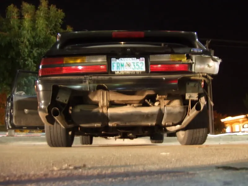

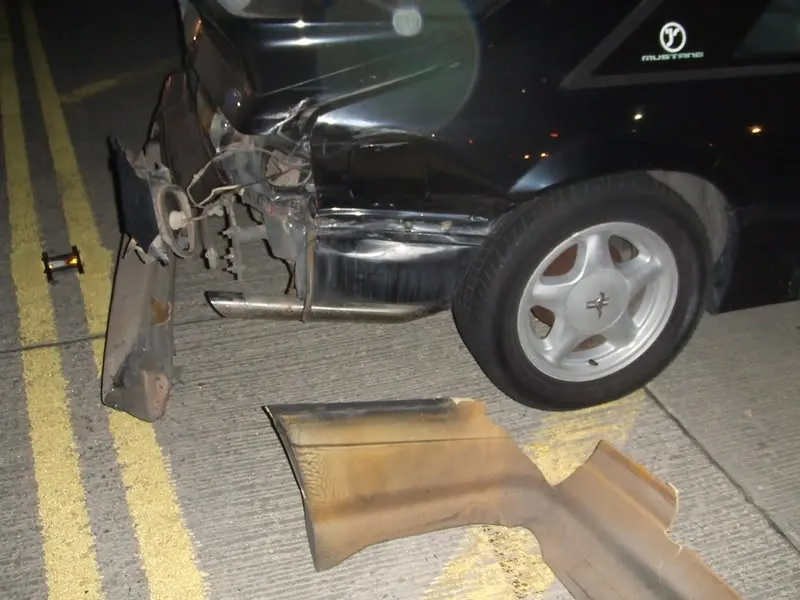

here's a pic of the damage

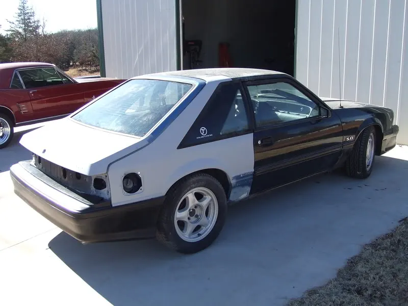

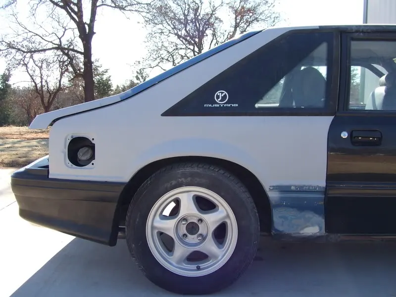

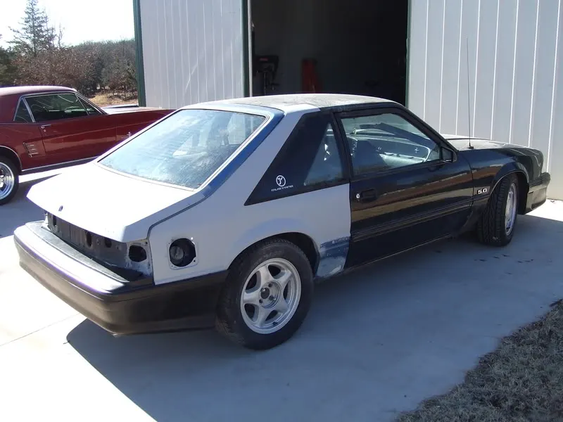

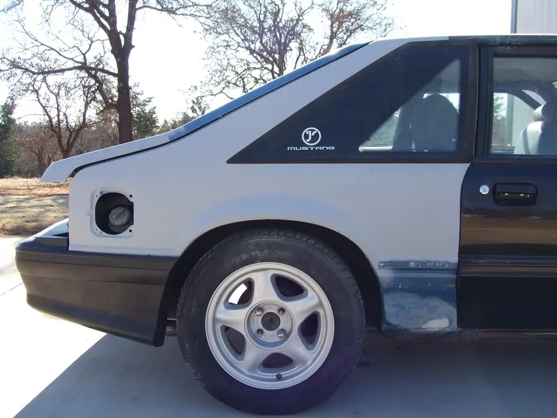

here's some pics after i skinned a new quarter
the rear bumper isn't bolted on yet in the pics. i got it as straight as i could, the door and hatch line up pefectly. but the tail light panel got twisted a bit and now the tail light doesn't sit flush, i gotta suck it in about a quarter inch. other than that, came out lookin alright.

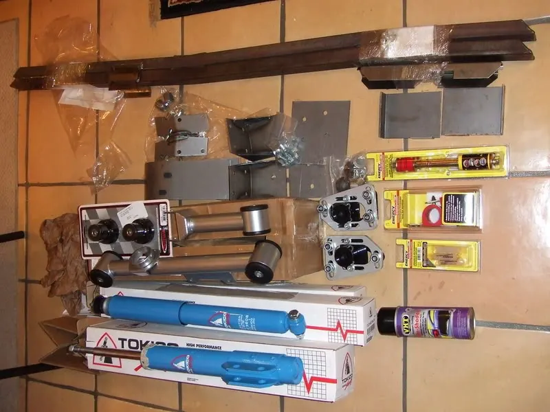

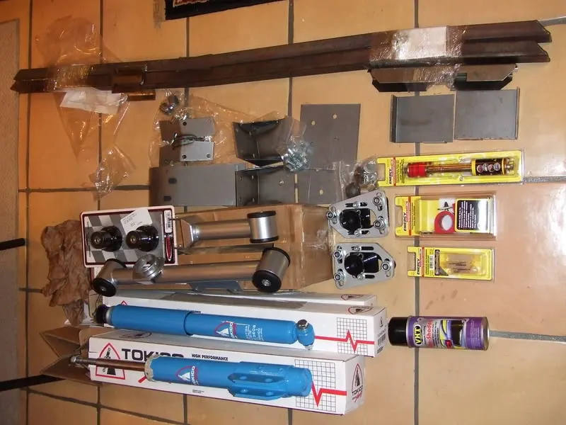

oh and here some stuff i got waiting to go on. i also have some kyb quad shocks and some maxspeed lowering springs that aren't pictured.

Looks great! How hard was it to replace the rear 1/4?
it wasn't too bad. just time consuming. the hardest part was skinning the "new" quarter. i cut a quarter panel off of a car along with all the structural innards on it. there was a lot of structural parts on it that i had to cut off. after that, i just cut my quarter off, cutting behind my quarter window, then up the c pillar and welded the new one on.

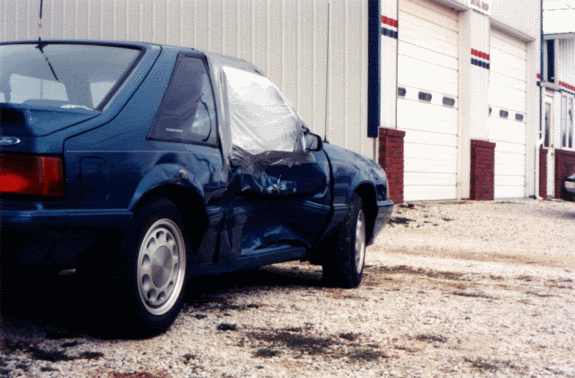

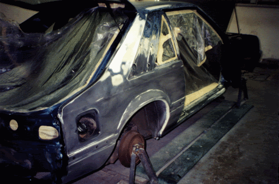

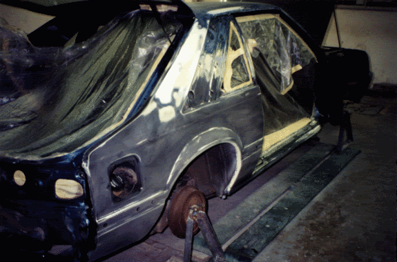

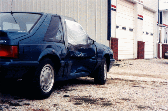

You make it sound so simple to replace the 1/4. I didn't do mine, but it looks tough. This is a picture of mine back in November of 1999. Final cost was $5200.
