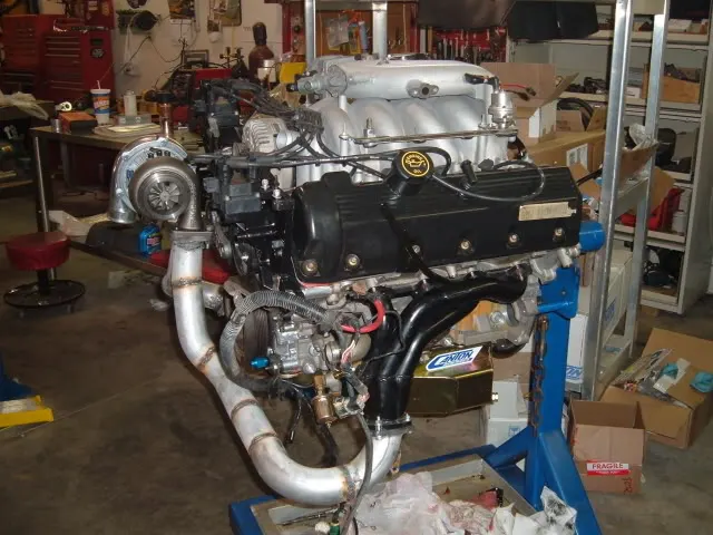

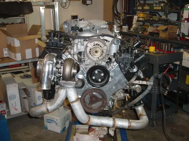

Well, since my new valve springs and MPH custom grind turbo cams came in, along w/ all the tubing for the hot section, i got started on fabbing up the hotsection. The longblock is now complete, just have to put it back in the car, and finish up the hotsection on the turbo, then coat it and finish up some powedercoatin some of the parts and then it'll alll go back together.
here's what i've got so far.

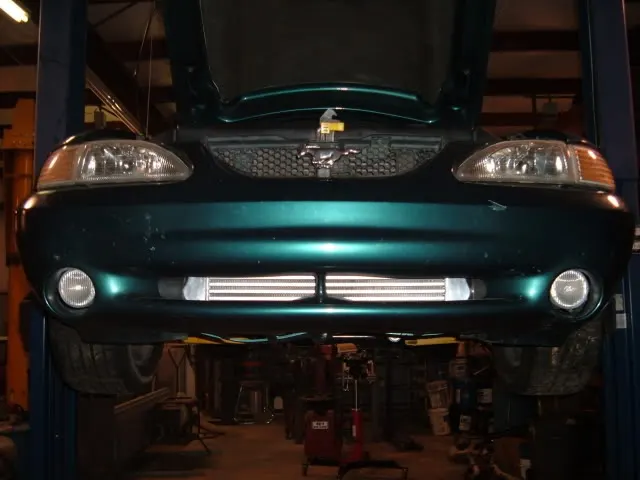

Yup.. The wholes will get covered/filled in, as they are letting are bypass the IC core. I've also got a good bit of ductwork to put in once all the IC plumbing is routed for the Power steering Cooler, and the Oil cooler.

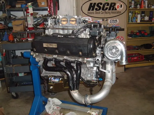

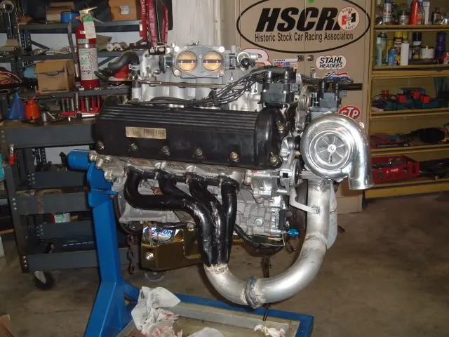

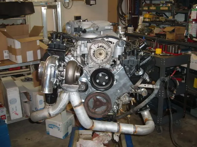

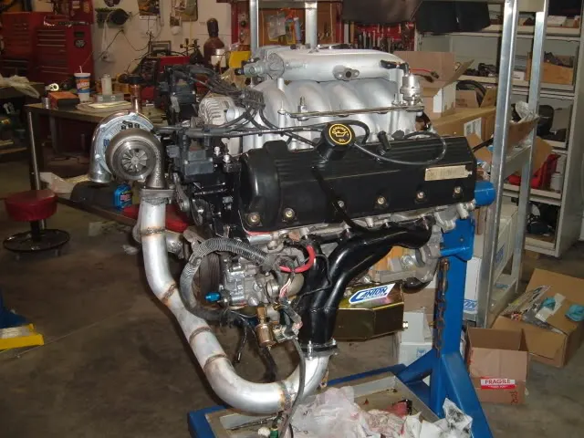

Heres some new pics from today. COMPLETE longblock w/ freshly powedercoated accessory brackets and you can see my PS coil pack relocation bracket is setup. The hot section crossover is fully tig welded and is 90% complete, i've just got to weld the PS header extension and v-band flange, then weld the O2 bungs in place and the wastegate tube. Then its ready to drop back into the car... Its getting EXTREMELY close, and i'm short $800 from finishing it up in the next 2 or 3 weeks :(

are those custom headers or bought then modified?
also seems like the drive belt might be kind of a bitch. the tensioner looks like it's a bit blocked, might just be the angle of the pics though?
The headers are custom made by Kooks. The Serp. belt is a PITA to get too w/ the turbo hotsection on. Actually its impossible to get to, you have to remove the hotsection to get to it. Which is about a 20 minute job (3 bolts and 1 clamp). And it still retains A/C..
