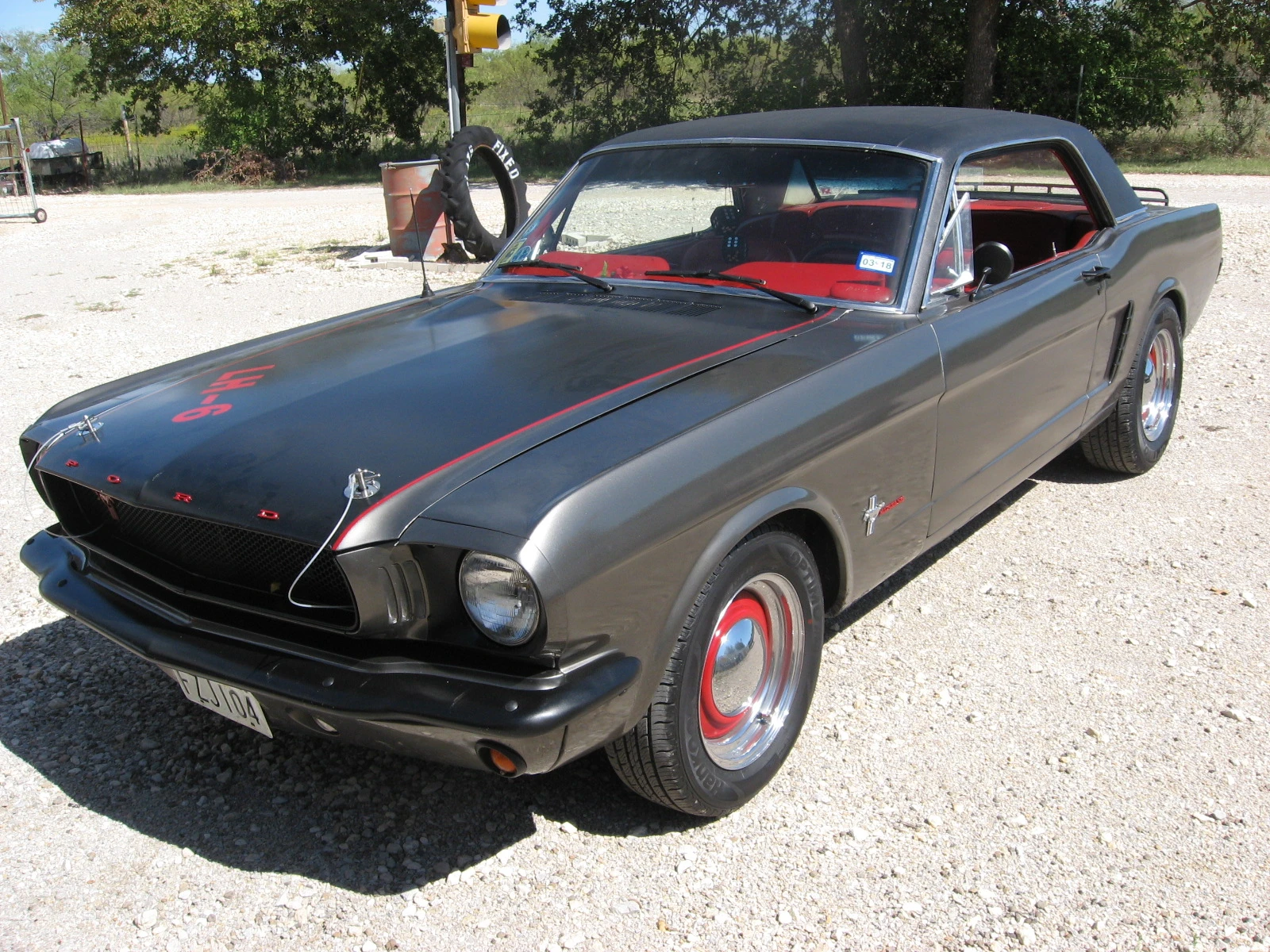

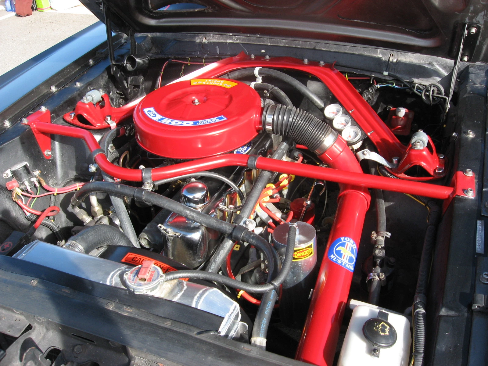

ok first, no need to add power steering, i have a 64 falcon without power steering and with the six, and it does just fine without the power steering system.
for the suspension and steering, go to opentracker racing products and get his blueprinted suspension components and his lower control arms with spherical bearings and roller bearing spring perches. this will tighten up your stock suspension nicely, and give you much better feel. while you are there do the shelby/arning drop where you lower the upper control arm pivot point 1" and move it back 1/8". it will also give you plenty of good feel and better grip as well.
one more thing add in adjustable strut rods with spherical bearings to eliminate front suspension binding and add in a little extra ajustability as well.
add front disc brakes to the car, power or non power it doesnt matter. my falcon does nicely without power brakes, and four wheel drums as well, but even i will upgrade to front discs in the future. there are plenty of places to get a conversion kit that will allow you to keep the stock wheels, i like NPD.
for better driveability you can add a T5 5 speed trans, modern driveline has the conversion kit you need, with or without the trans. that will give you two more gears, one being an overdrive, and a lower first gear to help launch the car. you can even step up the rear gears to a 3.50 gear.
charlie cheap did a nice job upgrading his six for daily use, so if you follow his recipe you cant lose. his build is in this thread;
https://www.stangnet.com/mustang-fo...et-driven-65-67-mustangs.906984/#post-9145065
one more thing to get while you are at it that will really help the front end stiffness is a cross member from zray;
https://forums.vintage-mustang.com/...le-street-competition-engine-crossmember.html
