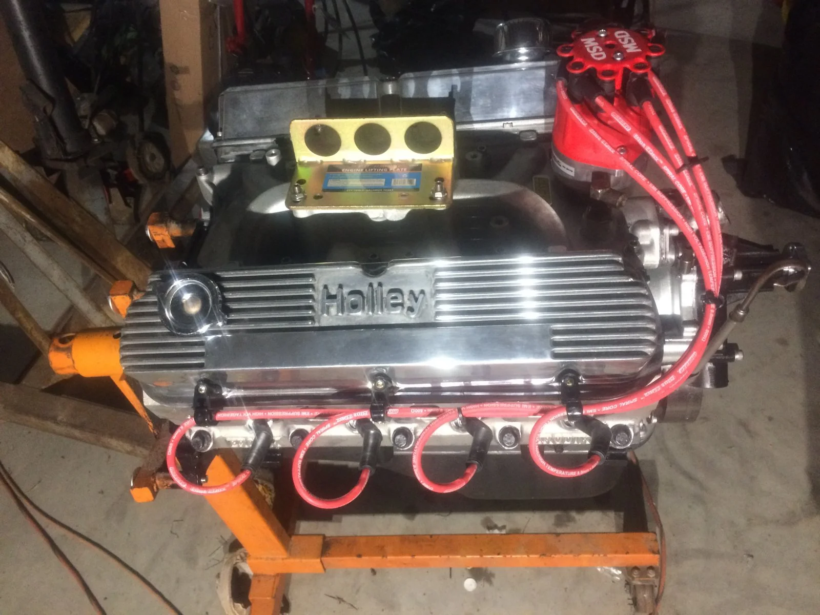

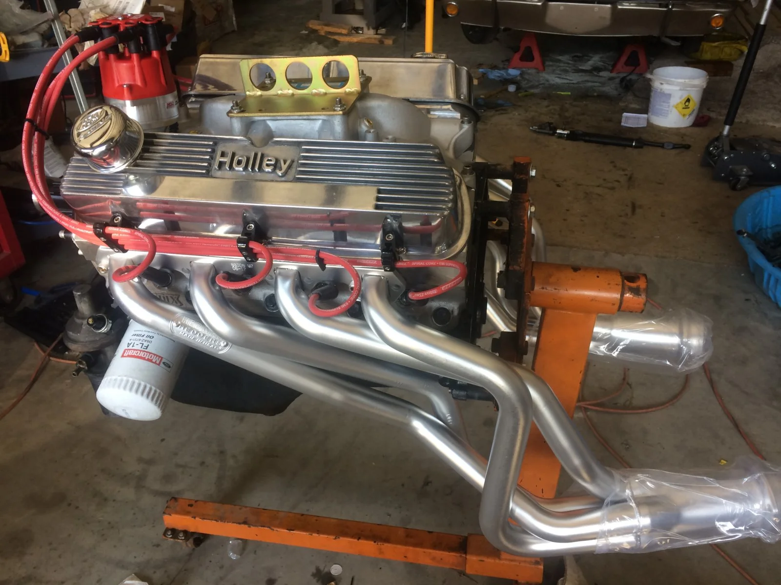

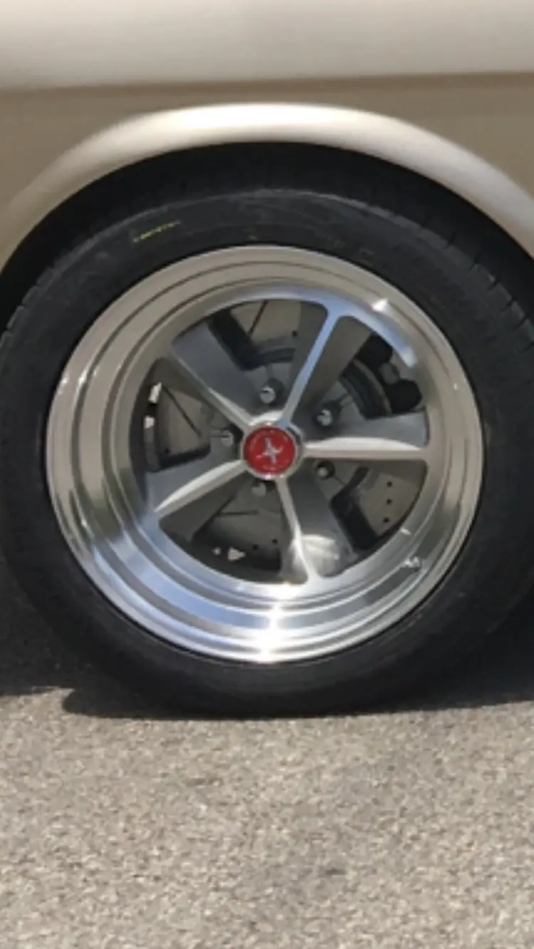

Totally agree about upgrading the brake system to at least front disc if not all 4 discs. Mustang Steve sells a great kit to install 2008 GT brakes at every corner. You will have to run 17 inch or larger wheels all around to clear those calipers. Feel free to hit me up. Just finished rebuilding my buddy's 65 doing everything you asked about.
