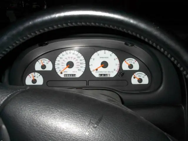

Not trying to be a smart ass here but why not buy the gauge face that are white like the Cobra's. I bought some off ebay for about $25 total, and they change colors.

If the circuit board is married to the original speedo than it would stay with the cluster, tach speedo and all other gauges are on complete unit---- the reason I am switching complete cluster is picked one up on ebay for around $75 and thought it would be alot easier than switching faces and having to recalibrate the gauges. not to mention it has that cool little decal that says SVT on it it kinda completes my 2K cobra R replica.
