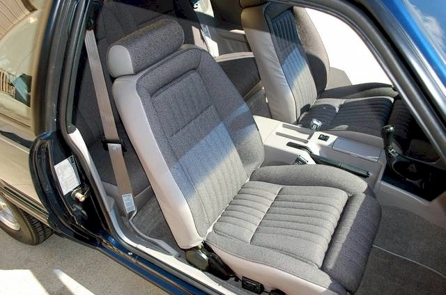

I'm going off the material and color as well. In 92-93, Ford ditched the pull out thigh bolster. Those seats appear to have it, so they are potentially 87-91 seats. The headrests are 87-89, but that particular shade of gray was really 1987-1989 only. In 1990 the gray color got lighter especially the vinyl sides

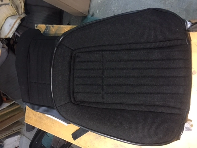

After viewing a lot of photos of 87-93 seats and most importantly, knowing the headrests were recovered on this monster (see my previous posts), it appears the height difference is in the area between the top of the quilted center section and the piping at the top of the headrest. The measurement on my seats is 3". 87-89 appeared to be more than that. The metal frame with no foam measures 24". So, I took a MASSIVE leap of faith and ordered a TMI 1990 full upholstery kit for an LX/GT, which of course is the 24" low back seat. I knew the headrests weren't going to match, but hopefully the seat backs would.
The Verdict: these are 1990-ish seats that must have been reupholstered in January 1994 with fabric consistent with an 87-89 and the 87-89 headrests were also used and reupholstered. The photo below is the new TMI covers prior to tightening everything down with hog rings (because I can't find mine right now and have to buy new ones). The fit is perfect! Can't wait to see them fully buttoned down with the rings!
So, any one want to trade up 87-89 headrests for a set of '90???!!!!!

Those are definitely 87-89. You are correct in the shoulder measurement, but also 87-89 had the oblong headrest - while 90-91 had the shorter rectangle headrest.
