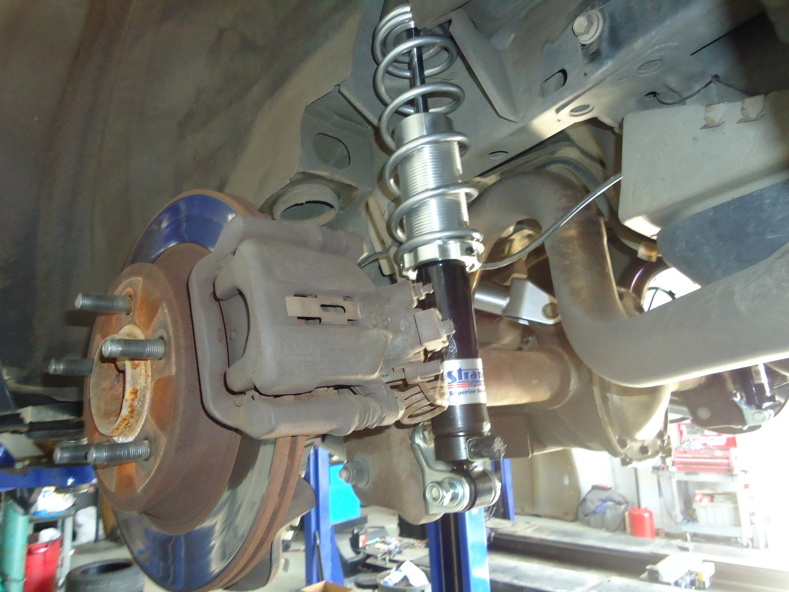

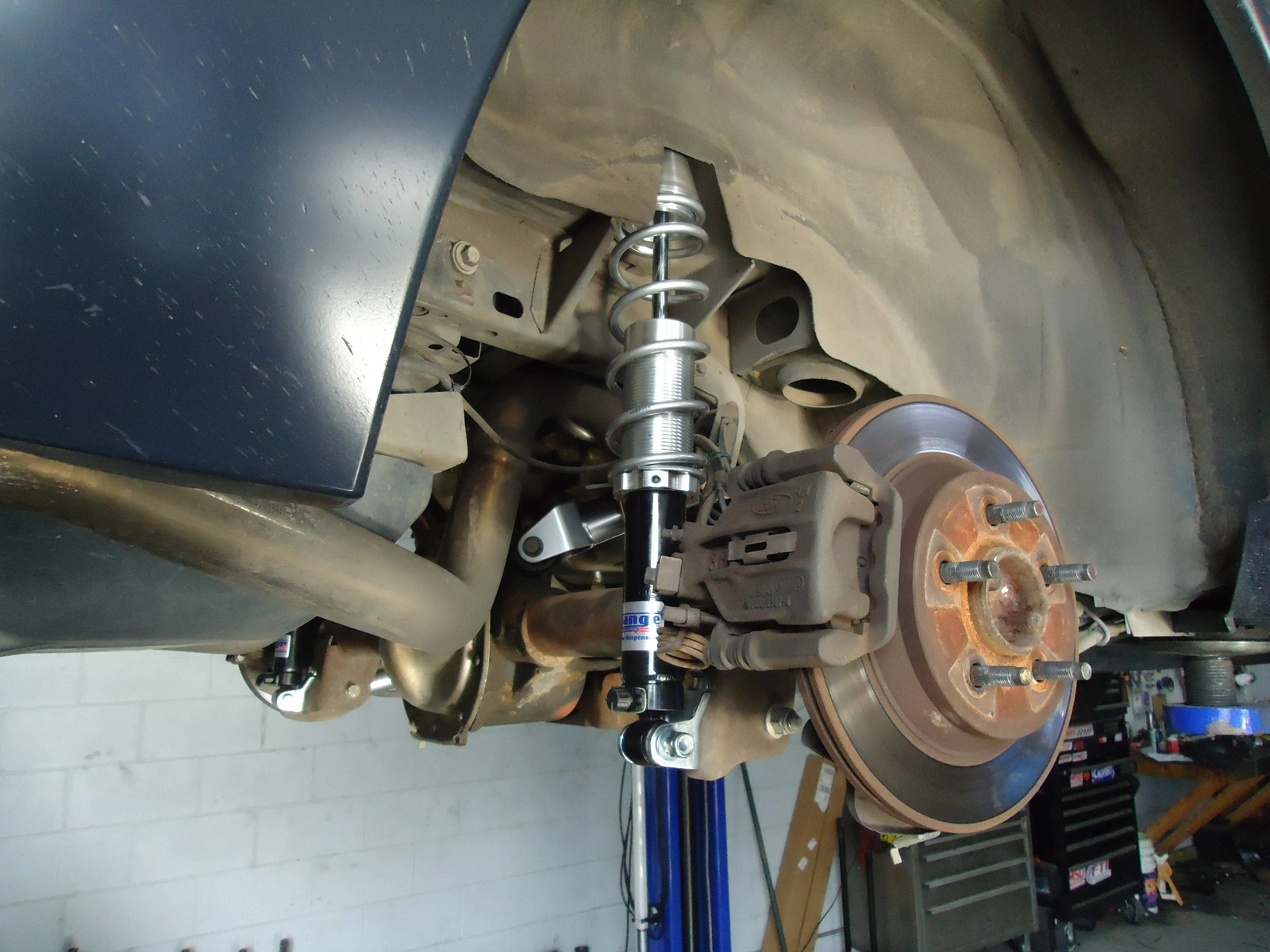

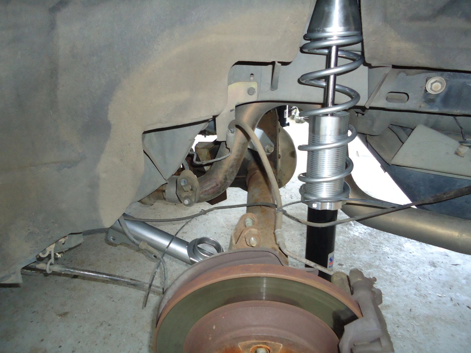

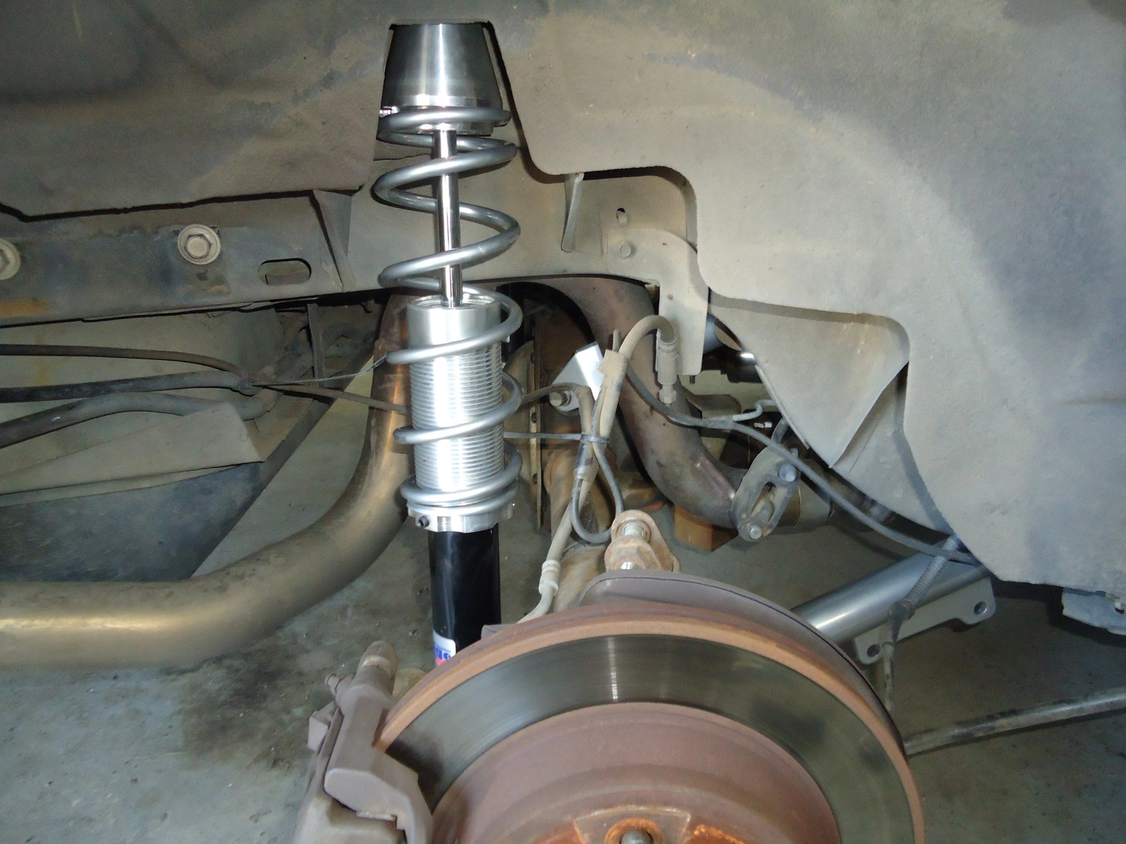

It's VERY hard to diagnose a suspension noise over the internet. Let's start with which springs you used? 10-125? Could you post a picture of the coilovers installed?

am going back to the shop in a moment, springs are 10-150 ( there was a guy there selling a set of 10-130 new QA1 for $50.00), when I get back I will post pictures since I took a bunch from start to finish. One thing I noticed last night in the trunk on the passenger side you have the three lines coming off the fuel filler and they go thru a collar down into the gas tank. I can grab them and move them and make a metal to metal sound so checking that. Did notice as well on the noise side of the car, the two top coils under the cone cap are hitting each other, surprised there is no type of rubber between the coil and the top cone. Last observation is the wheel well where it is notched and you can see the top cone, on the drivers side there is space between the two but on passenger side it is tight aganist cone, though can't see any rubbing. I will get my sway bar put on, for some reason they are fighting me on this. When you say run less than 20 psi of air, is this for the track only or all the time? I will be driving 100 miles to the track and will have an air compressor. I suck on computers but will try to download a photo or two. Thank you so much for your help!!!
Not sure why they are fighting you on the sway bar, that car NEEDS the sway bar put back on. 20psi at the track... It looks like you may need a little stiffer rear spring, you currently are all the way down on the adjustment sleeve. The Stranges will be louder then a stock set-up due to the construction, but they should be clunking around, if so they are set way to soft and cant control the spring....I think a stiffer spring would help on the street, or maybe a little taller spring.

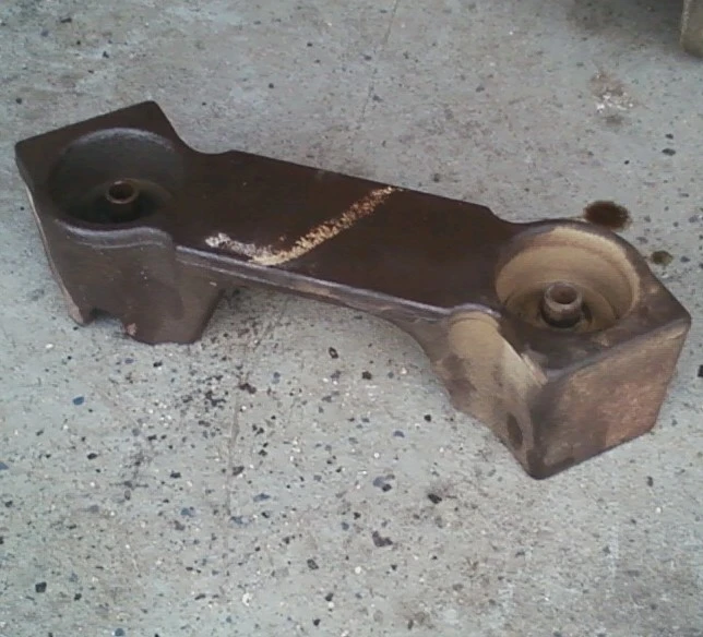

They still would not put the rear sway bar on, just cannot convince them, they want to put on when we get back. I just can't fight this anymore with them, set shocks on 3 and 15 psi and on street hooked real good launching at 2800 rpms. Concerning the clunking, the bushings are shot in the Dampner thingy and it was banging on the rear pumpkin. I removed it and didn't notice any vibrations so I ordered one and will replace when I get back with the sway bar. Right now the car is sitting at the same height as before install. I think I will have to find another shop to really get it set right with pinion angle. They also want to remove the front sway bar at the track. The springs are 150, your thinking stiffer or am I going backwards? Are you saying the collar should be threaded up more than what it is? I wish there was somew

About the clanking noise, is it gone now with the weight removed? One thing that occurred to me is that I've heard of people wrapping their shocks in something like electrical tape to eliminate the metal to metal contact between the sleeves and the shocks. A friend of mine tried that with his stock shocks and UPR coilovers and it worked.
