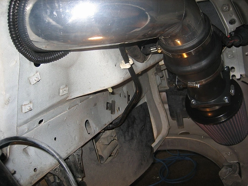

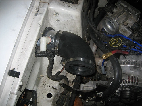

I will get some shots of it but I am not to happy with the fit and my work either. I had surgery on my hand three weeks ago and probably jumped into this project to soon. Oh well, It wont look to bad. I will get those pictures tomorrow. I took the day off (sore hand)but it should be done about mid day I Hope. I think they changed the pipe some because when I had one in my fox the bypass fitting was at the intake of the charger now it is way down by the MAS inside the fender well. I just did not like the elbow that the SQ came with and as long as this adds some more power(any at all) I will be happy. On a side note I paid $89 tok the door from billit depot on Ebay so I am not that dissapointed in the fit.

well I beat the pipe. What a pain in butt that was. I am not that pleased with the cosmetic aspect of it but in the morning I will start it up and see how it acts. I really found myself making a big hole. I guess once I get it all the small details finished up it wont be to bad but it definately does not fit this car.

this is a blower application. I do not like where the mass air is and I think I will relocate the air temp sensor to the fox location. All said and done its O.K. Now I need to get this thing tuned.
