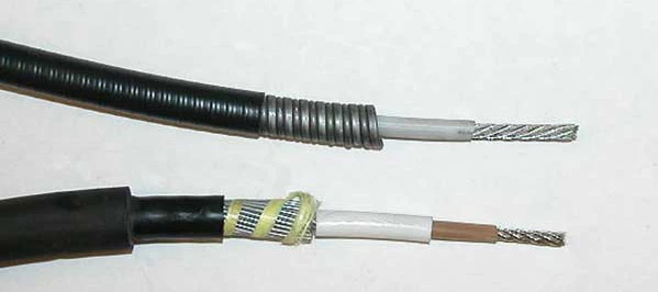

There's a reason people say to use OEM cables, it's because OEM ones have a lighter pull thanks to the way they're made, and nobody makes them like the OEM ones. The adjustable cables are the worst. When I went from an adjustable cable back to OEM I thought I was going to stick my foot through the floorboard the first time I stepped on the clutch.
You get all the adjustability you need out of the firewall adjuster.
Here's a pic showing the internals of aftermarket cable (top) with OEM (bottom)

What I plan on doing is measuring the size of the cable of my current adjustable and measuring the size of the UPR one. If the UPR is not thicker, I don't think I will chance it, and order a FRPP or MM. Anyone know the gauging or thickness of the two cables?
