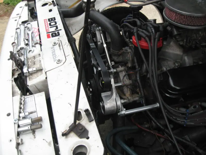

any one have one of them. i have just the alt,water,pump and i added a stock type part to make the belt tighter but the belt is making noise. i dont have any other parts does this just bolt to the motor
86-93 Mustang A/C Pump Eliminator w/ Holes
you will never ever get rid of the belt squeal with the routing of the belt as you have it now, there simply is not enough tension on the belt. I had the identical set-up for two years and it drove me nuts! I tried everything! You are using the march a/c eliminator kit, it's a completely useless bracket.
You could move the alternator to the driver's with a breeze kit or change out your water pump, backing plate and timing cover to a standard rotation and ASP grooved pulley.
