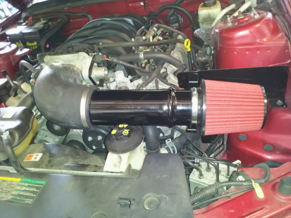

Installing the Cold Air Intake was very simple. The most complicated part of the process was transferring the Mass Air sensing element from the factory airbox to the Cold Air tubing. Piece of cake.

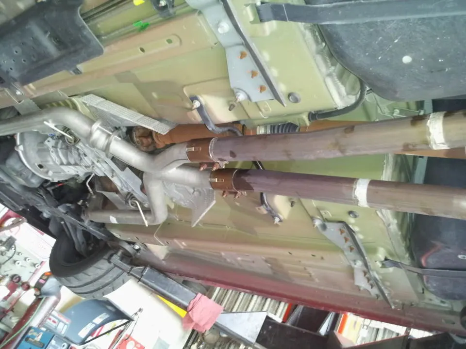

After installing the CAI, we moved under the vehicle to install the off-road x-pipe. This was another simple job. The only item worth noting here is that although the factory O2 sensor harnesses were long enough to reach their positions on the new pipe, on the front passenger side sensor the harness was disconnected from one of its brackets near the firewall in order to reach that particular sensor. No problem. While we were under there, we installed a pair of OEM GT500 mufflers which were given to us. Like we said, budget project!

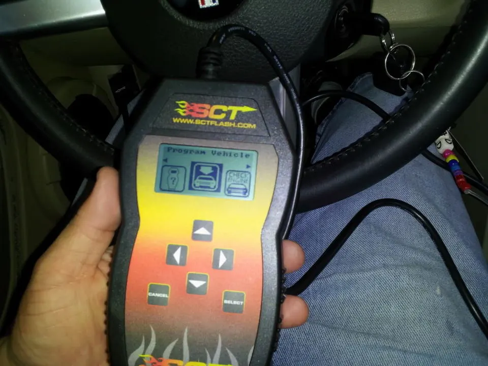

With the CAI and exhaust installed, our last step was to load the new UPR Pro Series tune with our SCT X-calibrator 3. I'm embarrassed to admit that I've only ever tuned Fox Mustangs, so this whole SCT OBD tuning process was new to me. I'm pleased to report that it was SUPER easy. The SCT tuner guides you along every step of the process. Loading the tune may have been a five minute job, if that.
