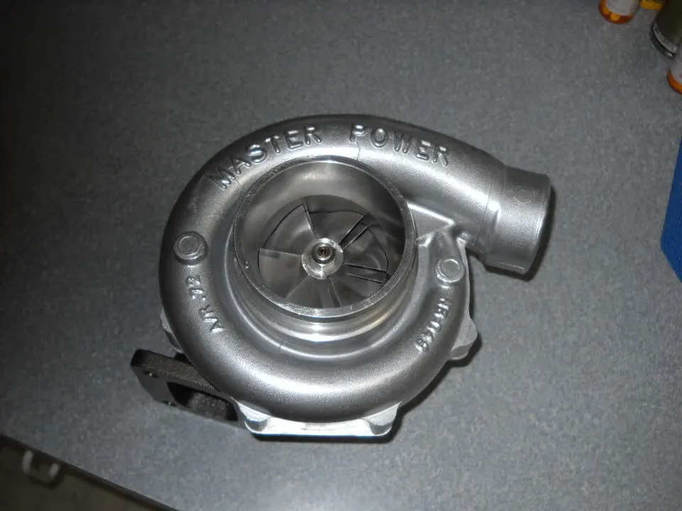

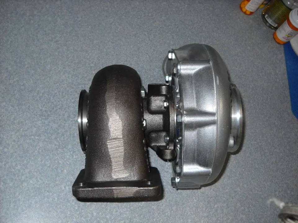

master power T76 p trim
since on3 doesn't deal with masterpower anymore, i ordered the turbo separate, and will be ordering the rest of the kit soon! going to get the hot side jethot coated "polished" along with the turbo headers to match the cold side, and the rest of the polished SS piping
then plan is to run about 10lb's, E85 and hoping to make ATLEAST 500rwhp, really would like 530rwhp, 200 more then N/A:nice:
You're going to need a badass fuel system for 500rwhp on E85, but motor-wise, you should be in your power range at 8-10 psi. Have fun!
Nice! 500 should be NO problem!
i hope so! im thinking the edelbrock & 6061 upper combo with boost, and e85 should be a power maker!
