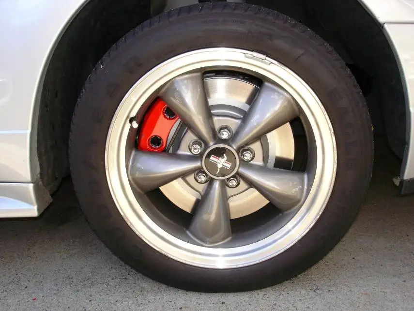

Ok pic time
First off, BLEED YOUR BRAKES! This is just nasty. This stuff is only 3 years old yet it came out black. It took the entire 32 oz bottle to bleed it. Pedal feel was MUCH better even before i took it for a test drive. Just in my driveway the pedal felt firmer and less spongy. I used Valvoline Syn Power brake fluid and i plan on bleeding my brakes yearly from now on.
Out with the old
In with the new!
They look like Bullitt brakes minus the pony. Not really a bid deal to me. I like the look.
Hmm, just noticed i have quite a few Mach 1 styling cues on my car now
