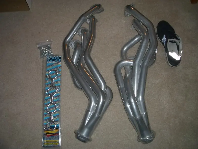

looks like good quality pieces.. One thing tho, those 16 header bolts they sent look like a joke to me. No washers or nothin.. i guess im gonna reuse the stock studs. And they sent 4 studs and locking nuts.. im assuming for the lt to midpipe connection? i guess im just sayin i wished they sent some lock nuts for the header studs. anyways, im gonna get the stainless steel vrs o/r x soon and takcle this along with my awaited motor and trans mounts, and steering rack bushings.:nice:

Use hi-temp silicone gasket maker around the gaskets and reuse the stock nuts on the stock studs and you won't have to worry about them coming loose. The 4 studs they sent are for the midpipe flange. Screw em into the header with loctite. Hope you also got a new midpipe with that deal, but sweet looking headers. Mine were just HTS coated and are now half rust-coated after 1.5 years.
thanks.. yea i was hopeing i could reuse the stock studs and nuts. i have the percey gaskets tho.. so ill be using them. Im going to go with an x pipe (stainless steel vrs).. o/r for now, and than add cats to it in the fall
