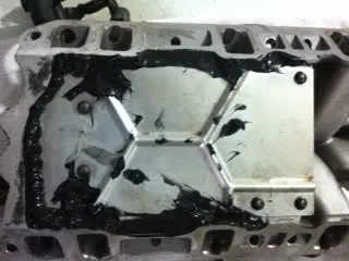

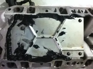

So after bouncing back and forth on whether to buy a different intake or not we decided on this.....
I know its kinda redneck but if it works it will have saved me a bunch of money and others will be able to do this or something like it and fix their oil consumption problem.
Its not the gaskets as they were sealed. So well in fact we had to pry the lower intake off with a pry bar. This is a well documentented problem. Hopefully we fixed the problem. As soon as the oil gets changed I will find out.
