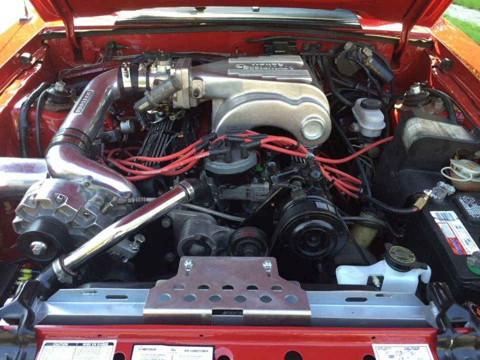

Some Pictures.
Fan and Rad:
http://s1116.photobucket.com/user/twildt/media/1989%20Mustang%20GT/Electric%20Fan/20150718_132651.jpg.html][/URL]
Clearance from Top:
http://s1116.photobucket.com/user/twildt/media/1989%20Mustang%20GT/Electric%20Fan/IMG_20150718_132203.jpg.html][/URL]
Clearance from Bottom:
http://s1116.photobucket.com/user/twildt/media/1989%20Mustang%20GT/Electric%20Fan/20150718_133137.jpg.html][/URL]

that the fan i have?...i also have a bcool aluminim rad,mine doesnt clear?....hmm maybe i should check again

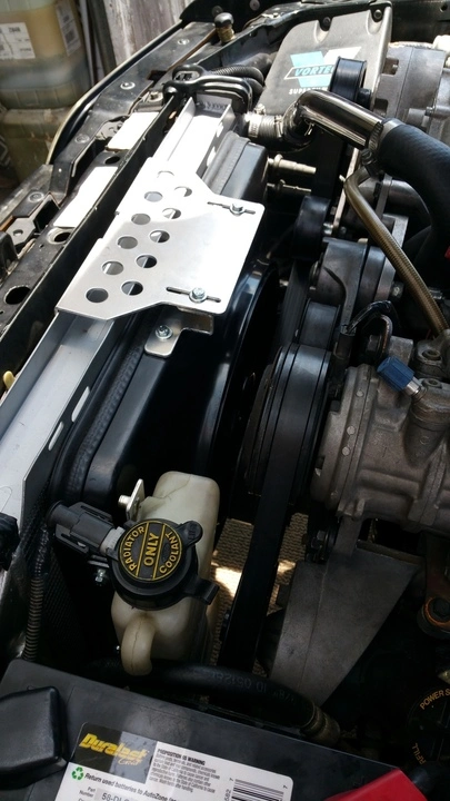

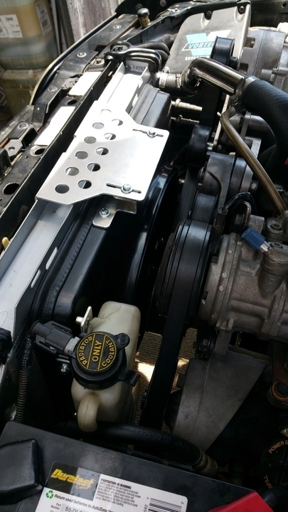

this is my set up with the same fan as yours?,looks like its sitting in the factory position?

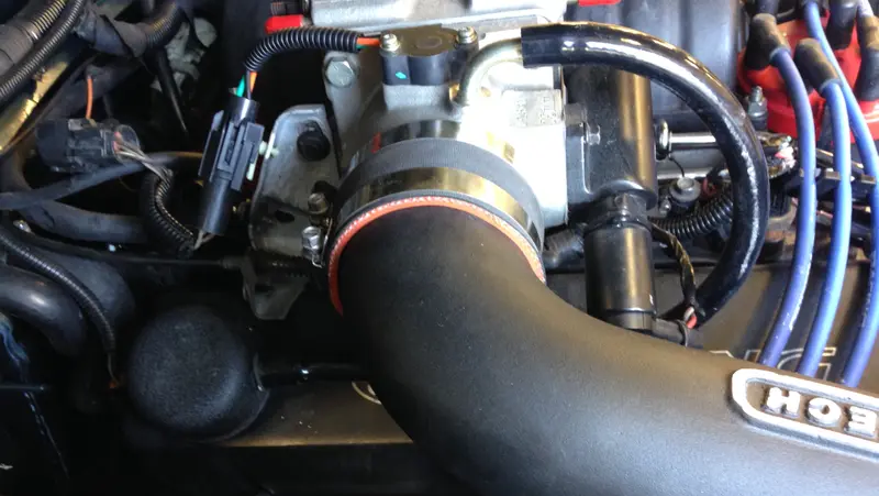

@stang89bidges ...also wanted to ask you or anyone,am i supposed to plug the top of the tb where that hose is pluged in?,then put a breather on the valve cover on this side only?

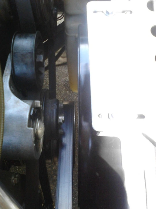

Yep we look the same setup. Mine didn't clear either until I unbolted radiator supports, got under car, lifted radiator a little and pushed it towards(just bottom of radiator) front of car. It stays put as long as it's still sitting on the rubber floor supports. Then just get your upper rad supports bolted back down. I also had to really push in on the electric fan(best if you have help) then tighten down fan supports. All of this got me the clearance needed.
Yeah I plugged my TB. I run a hose from filler neck to cold air box. I will post pics of that later tonight.

thanks man.!....i do see that there is a plug in the vortec set up,but i have a anderson ford power pipe so im not exactly sure what to do?

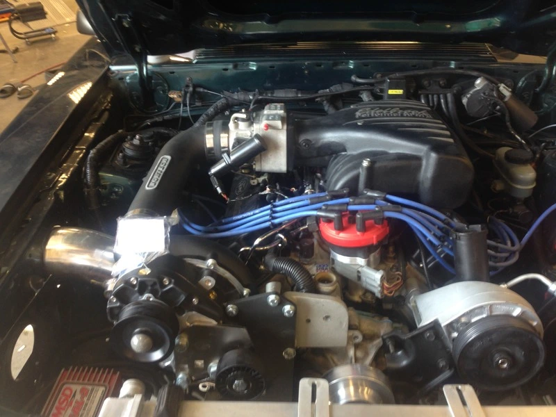

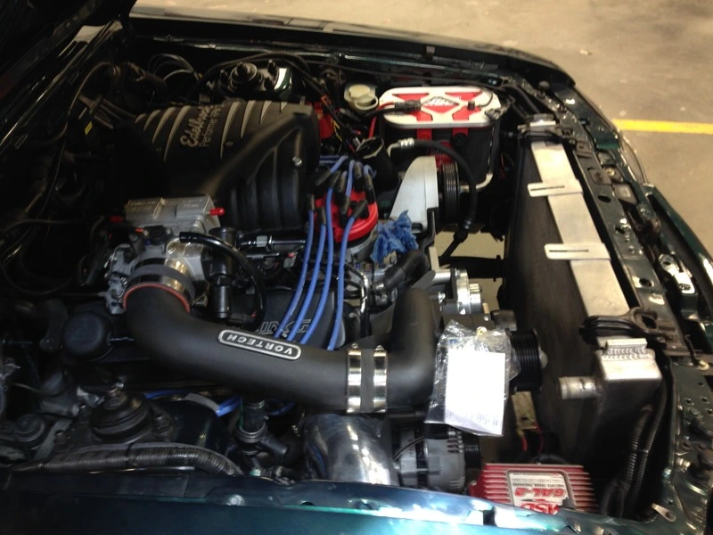

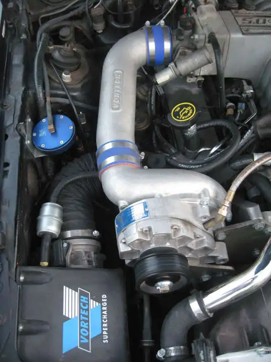

Found a picture that should do. If you look closely you can see the plug on TB. Just a rubber plug with a small hose clamp. The hose I run from filler neck is 3/8 I think. Slides right on the nipple below filler cap. That runs over to cold air box. I used a small fuel filter between. It's connected to cold air box by a simple threaded brass fitting. Just drilled hole and threaded it in the plastic.
Yours is inside the fender I see but you can figure something out pretty easy. It just needs air.

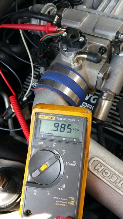

Here is better picture of the plug. This is an exclusive pic of my new setup. I haven't even posted it yet in my rebuild thread. . LoL.
And hey, you get to see some great footage on setting your TPS voltage at the same time so hoorah.

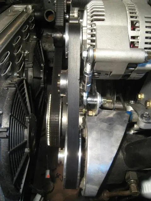

Here is another couple options for smog delete.
1. You can do what this guy did if your not planning on A/C.
smog pump delete with vortech - Forums at Modded Mustangs
Pg. 36
2. Do you see the threaded bracket in his pics. The one on drivers side front of alternator. You can simple make one of these and delete the smog pump where its located now, and use that from alternator to vortech bracket. I'm planning on doing this option because I kept A/C. Also you don't have to make the rear bracket or relocate the alternator.
This is a good shot of the threaded bracket that I'm making for option 2.

I don't think you can put a breather on valve cover. I think it messes with the pcv valve or something. I read about it somewhere but can't remember all the details. Someone smarter than me can provide answer to that.
Edit: I just noticed you don't have the valve covers with filler neck. You already have a filter installed in back of passenger side valve cover. I would imagine if that's working then all you need to do is plug off the TB and call it a day.

It's either all in or nothing with the pcv you shouldn't run the breather and pcv together . I am plugged with breathers on my vc . You must delete the line that goes from the throttle body to the valve cover or else it would be pressurizing the crankcase whether you run the pcv or not . The design of the systemax which I have read many other have the same issue makes the pcv draw oil into the intake path like a siv which is why I chose to plug it off and run open breathers.

To answer it supposedly draws air in after the meter and can cause surging issues and mess up the air fuel . I have yet to have a problem last year I ran just. A filler neck with the filter and then with this motor I needed the baffles . So I went to carb style with 2 breathers and no more oil on my vc and the car runs identical to the way it did before I switched .
