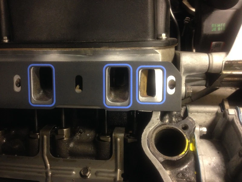

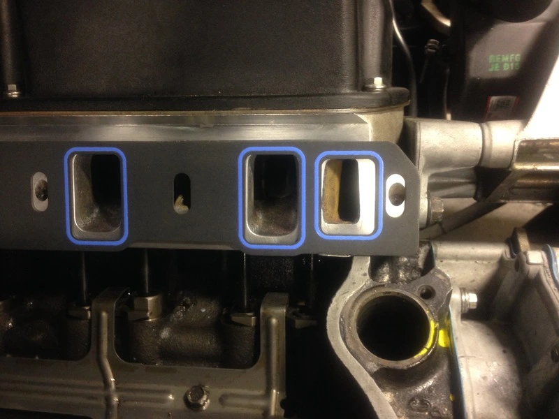

@mikestang63 this is felpro 1262s-3?....am i ok to use this?

what was on mine was 1262 i believe with the tabs cut?

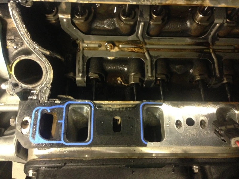

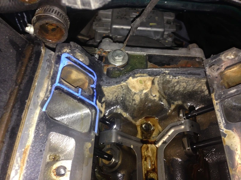

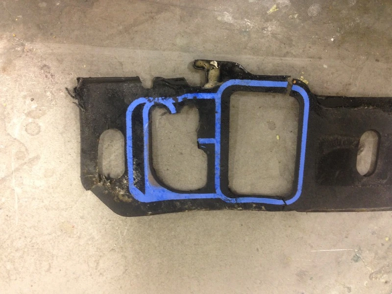

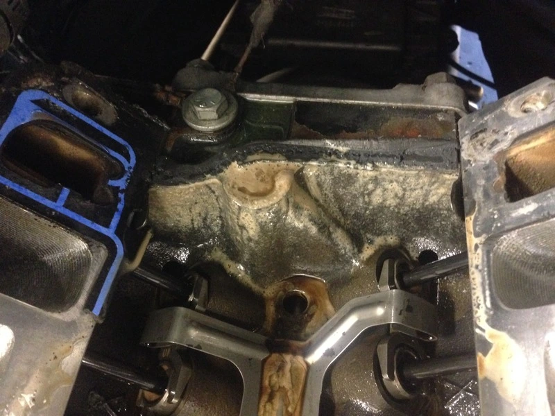

here are the pics....sorry somthing is glitching
this is the one that was suspect to me?....lots of coffee in that side?

My last two pairs of 1250s3's i didn't have to cut that tab. Dunno if they changed it from an earlier version or not. That is usually where the paper ones fail though.

the 1262s3 the one at the top seems like it has very little gasket on the sides?

smkshw said:
yep -- that is exactly where the print o seal 1250's fail. Around the water jacket. Did you put RTV around the water jacket opening, as that causes distortion to the gasket.
