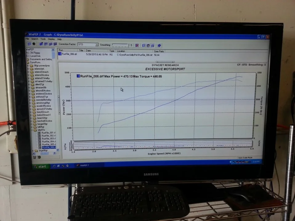

You should be similar to here.
My stats are similar to yours. Not sure what pump your running but I have an Aeromotive 340. This was with various air and coolant leaks from the new build..... all fixed now and she runs like a scalded dog!
nice!....thats with 6psi right?......and all the info you guys neeed would be on my dyno sheet?....or do i ask for somthing else?

This is with 10lbs kickin! @smkshw
Reactions: smkshw

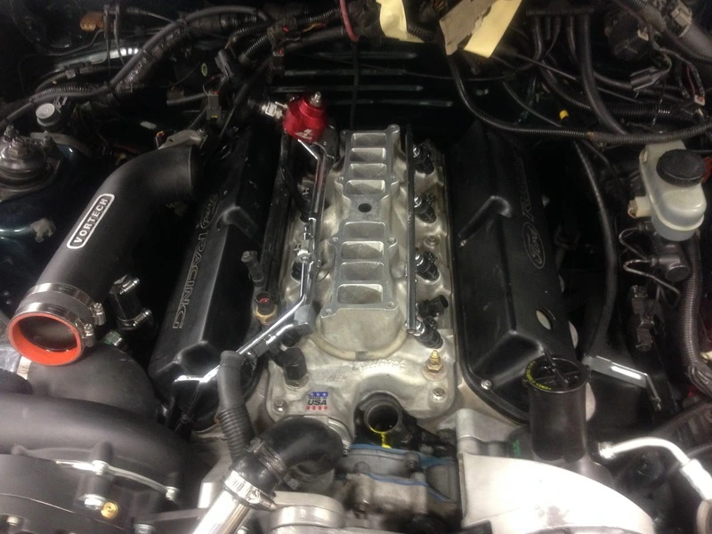

mikestang63 said:
I'm going to guess- the intake gasket shifted under boost- get a set of 1250S3 or 1262S3 depending on your port size. They have the steel rings around the ports. Use a bit of camel snot to keep the gaskets in place when you lay the head down and put a nice 1/4 bead of right stuff on the front and back china rails- let them set up for a few minutes. Cut some long threaded rod and put one in each corner where the manifold goes down into the head as a guide When you lay down the intake just finger tight all the intake bolts and then snug them up in 3 phases- 5,15,22 lb ft torque and let it sit for a few hours. Then come back and retorque all the bolts. Then you can put the upper on.
is this with aluminum heads?....afr says hand tight?....im torqued at 18fp right now?
i dont think it matters from 18/20/22 .. i would def do more than hand tight man.... matters more that they are torqued in steps and evenly..
ok....i did 5-10-15-18....ill leave it there dont want to strip it!...lol
let it sit a few hours and then go back and retorque them. You may also want to check them after a few heat cycles.
i already did that,and over night......i know i didnt do that when i got the engine so ya,i guess ill take the upper off and re torque after a few rides to be safe!.....assuming everything goes well!
