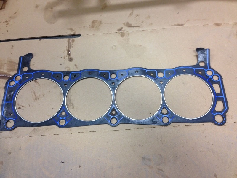

well,took the driver side off and everything looks fine with visual inspection anyway....i dont see any crackes and head gasket looks fine to me?
