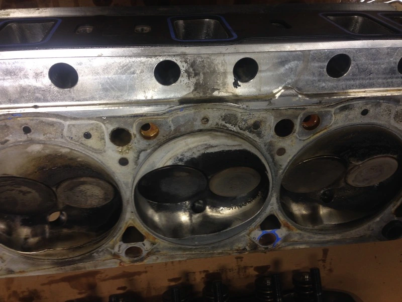

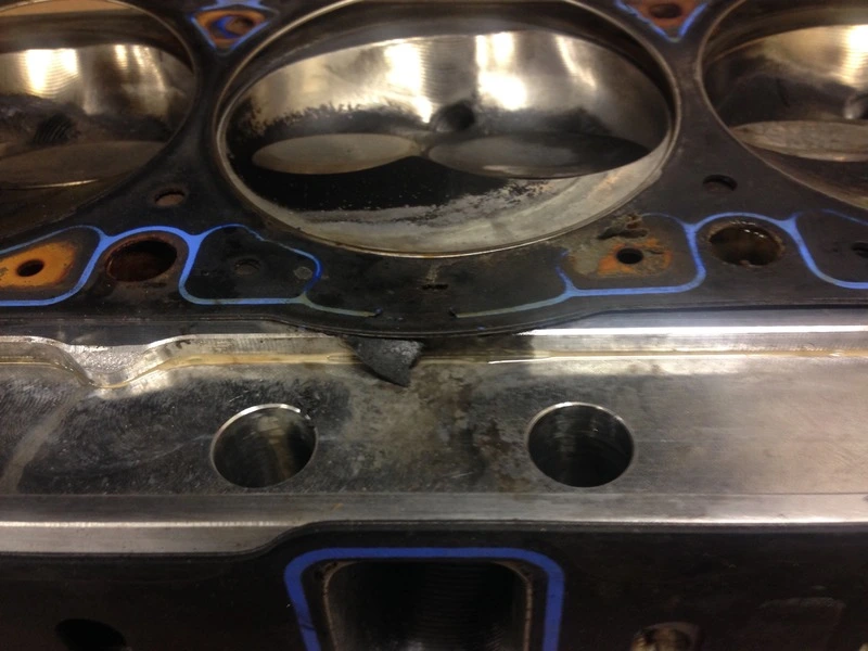

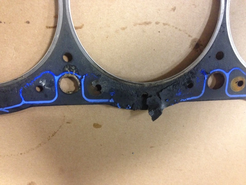

its a water jacket,looks like it was going right into lifter valley?,and thats the only cylinder that has some white on it?.....i really hope that didnt happen when i took it off!....i only did one head gasket before on a 4 banger and it was blown out the middle,so that was 100% definitive.

Im no expert reading head gaskets, but those look like felpro 1011s, which tend to not like boost. If the experts here can tell if that is your problem, change to 9333s, they take a bunch more abuse and are slightly thicker.

9333 pt1 are a good stock replacement gasket that can take abuse with some boost . That gasket doesn't look healthy and white on the.cyl says that's prob your issue . I'd stay away from MLs gaskets on your car cuz as you see the gasket was the fusible link in the situation .

a touch, the 9333 is .008" thicker than a 1011. i dont know the full specs on your motor, but running the calcs on mine the 1011 is 9.65:1 and the 9333 is 9.44:1

Yes. Not sure on that particular gasket you were running(thickness wise) but get the thickest one you can get and it will lower your compression. That gasket/head looks like it was bad. So hopefully you found your problem. And I also recommend the 9333's. Good luck!

Unless you get the block and head PERFECTLY straight and they are prepped for them., don't get MLS gaskets. I've run 9333pt1's on every mustang I;ve owned for 25 years and they are fine.. They have a better fire ring than the 1011's and IMO you want the head gasket to be the fuse in the system.
Check the block and heads for straightness while eveything apart and get the surfaces squeaky clean using razor blades, green scotchbrites. I don;t like whiz wheels on aluminum. Make sure you put the HG on so both front go to the front and look up- one will look wierd but it does go that way.
