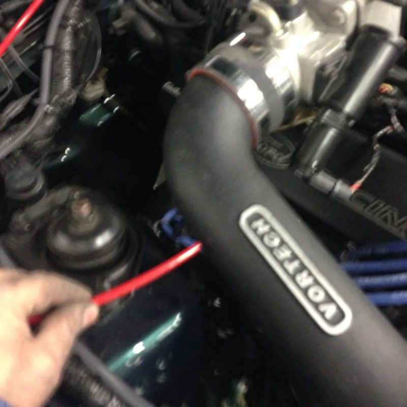

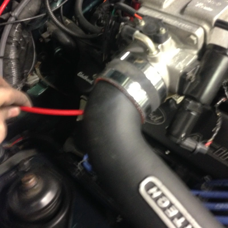

Hey guys,instructions so to install nozzle within 6" or throttle plate at a 90deg angle to the direction of airflow?
This is 6" from throttle plate?....does that seem right?
Or
a91what

Either will work fine you could (in theory) remove and tap the vacuum elbow on the tb, of course only if this activates at WOT. If too close to the tb the water will condense on a partially open plate.
Just food for thought

Ok....just wanted to make sure thanks!
