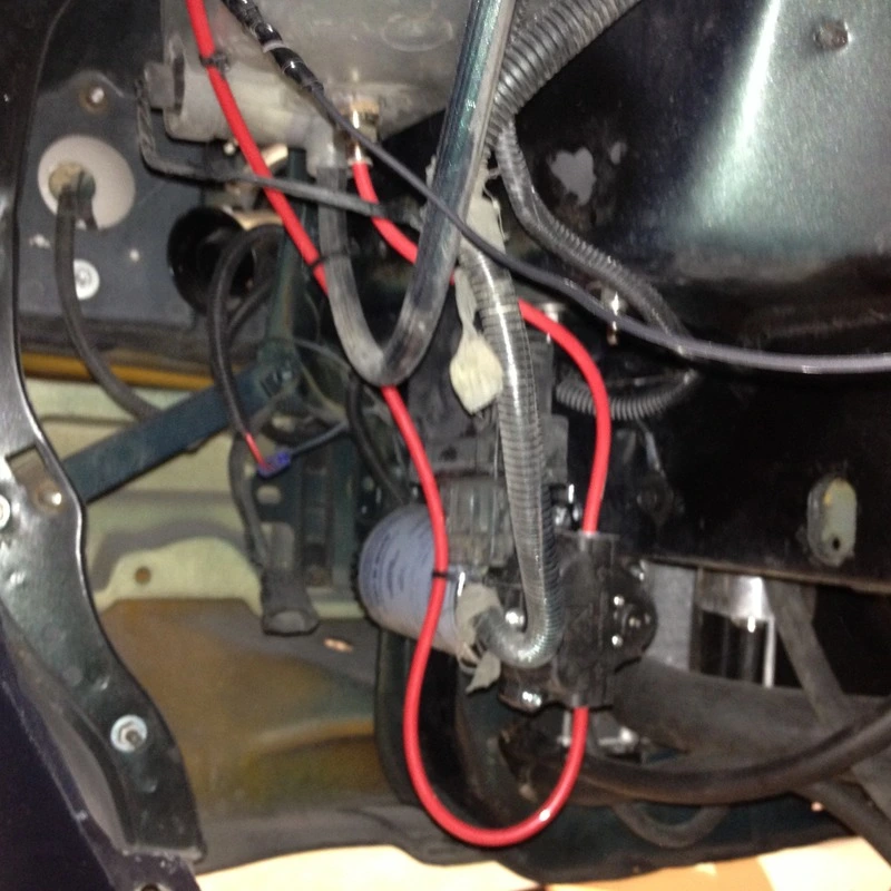

Well might as well post the finished product....just waiting until next fri now...i tucked the pump in the fender and tapped into washer bottle,only thing you can see is the nozzle.
