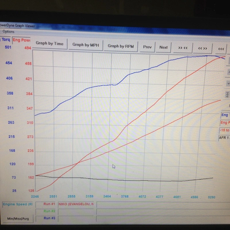

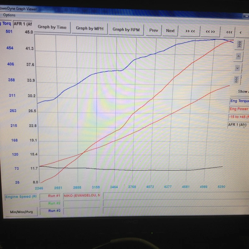

He emailed me the dyno sheet where its at at the moment..
smkshw
5 Year Member
Feb 12, 2010
1,095
235
94
Jan 31, 2016
#543
  • Jan 31, 2016
  • #543
The graph looks great compared to the other place?!

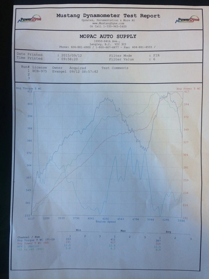

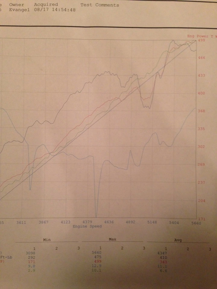

This is dyno sheet from the other place..."mopac"
This one was detonation=blown headgasket!
And this was where it was at before i took it to new guy...detonating and bucking,and hardly holding an idle....thats what $1000 plus $200 dyno time gets you

I am really kind of surprised that you're running out of injector.
It's pretty clear though, that the first place had no damned idea what they were doing.

nice numbers!! talk about a linear torque line.. nice A/FR as well... looks like a conservative tune too

Thanks guys!.....Ok,so he called me back,said that he couldn't compensate for the injectors,so numbers are the same,told me that I'm fine as is as long as it stays below 5300,but if it was him to put in 60pound injectors and come back for a final tune.
but he says otherwise the car runs great!!,and I will be happy!!....he wants to take me for a rip first before we square up...lol
