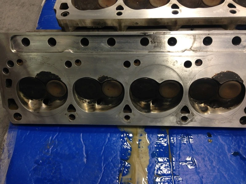

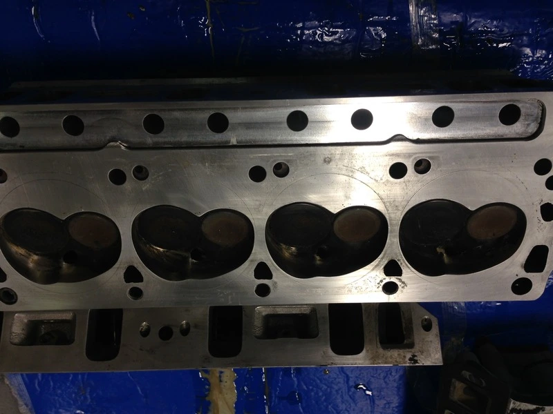

I did a quick check tday,i dont have the machinest straight edge but i used a ruler from a angle square,and a machined metal bottom level.
Kinda hard to tell,i just touched it with my fingure to hold it there and in the suspect spots with a little force i can maybe push .0025 through,if i just let it sit there i can push .003 through,thats length wise...across theres a .003 woble over most of the piston areas?...the fire ring made an indentation that you can feel with your fingure in the head?...,so if thats warpedge then its warped?
Kinda cave man expanation but i did my best...lol...was going to wait to get the proper straight edge but i think ill just get a min deck?.....heres a pic of the heads...i do also notice that they are both pitted?

The one at the bottom is the one that leaked.....also, i did i length and vertical test on the block,i had no room for diagnal,ill have to take my sc off to go end to end but i wasnt able to fit anything under the straight edge...????

Oh,and tuner came by my shop tday,he said that the fire ring held fine,and that it might be warped head or block,and to tighten the head bolts from what it was torqued too,70-80 to 80 and 90,and to check my torque wrench?
Thoughts guys??

if the head or deck is warped, it doesn't matter how much you overtorque the bolts. All you will will do is end up compressing the HG more and warping the head- aluminum warps easier than a stock iron head.
As you didnt have a true straight edge I can't say for sure, but .if you can feel the indentation and there is at least .003 of gap, that isn't good bro

Ok i understand that....so assuming my block is good?....by bad you mean re deck heads?

Well im sure i found my problem...i guess those indents are causing the fire ring not to hold?!....has to be decked for sure,but what will that do to my compression!!??
