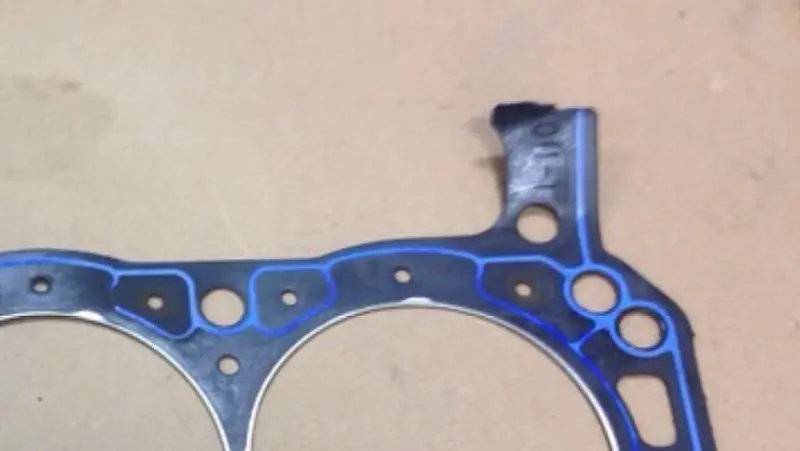

Ya,he said hes worked with higher cr with meth so i hope your right....worst case new heads!....damn it...lol....if i was able to run the cometics i can play with cr more also,another option....but ill have to take the engine out...

smkshw said:
They are 58cc.I was thinking the same thing....but $$$$......!!!
Is that normal wear from having 2 head gaskets in,or was there an issue is what I'm wondering??
if your deck is warped, imo you need to have that addressed in order to maintain the necessary seal. That requires removal of the block from the car. You can get custom HG in different thickness to help lower compression but that won't do anything about sealing.

Man this is a tough decision you have to make. If you even suspect the deck on your block to be warped you should have it checked. And this requires removal of engine and dismantled for machine shop. Usually dismantled.
Best check those heads too. If they get milled you need to blueprint them so you know where you stand for the next time otherwise you won't know how much has been taken off in total and you risk P2V clearance issues during reassembly.
And if your pushing 500HP, like I said before and so have others, your pushing the limits of your stock block. Therefore if you take that into consideration, you may not want to spend the money on this block with a mill. It may save you some money but your going to end up rebuilding the engine if you get this far so now you may be better off finding a better block that can handle more HP. This needs to be a block that can handle your current internals if your trying to save money. Either way, it's a rebuild.
IMO, and take this as you will, is to have that deck professionally checked and the heads to see where you stand. Then start making big decisions after the results. If you slap this thing back together without these checks your going to end up spending more money in long run than rebuilding existing block or new one. Your in for the long haul buddy.

a91what said:
Seriously?? All that cost to just lower the CR? Would it not be more cost effective to just pull a few degrees of timing or lower the psi, your running meth right? The cooling effect will stave off detonation very well.
Just my .02
Seriously- it was just an idea . We know the cooling affect will keep detonation down because the heat in the chamber is lower . Which for obvious reasons is why it was put on the car .
He already had the heads off so its peace of mind knowing he isn't taking too much off his heads , in turn raising the compression even more . Starting with a fresh head with more combustion chamber lowering the comp down . Again I only suggested it cuz the car is apart again.
Sent from my Samsung Note 4 using Tapatalk
I know the heads nead to be decked,guaranteed its coming from that spot,you can see and feel the fire ring pushed in the head exactly where it went under,so that wont seal for sure.....but if i get it redecked its going to a professional?...lol....do ppl actually do it by themselves?
I did a feeler guage test at all the spots,used the angle finder ruler part though,i will confirm with the proper machinest tool,but block seems fine....
At this point if i cant use the heads im getting a proper set for a sc but no way im starting a build again from scratch!...lol

Sounds like a plan. If your comfortable with the deck tests you can perform then you have your decision. Good luck man!

Ya i couldnt get .002 through at any point....thats the smallest it has....going to confirm still but nothing major so far...the heads not so much...lol

Man I hope the block is good to go. I hate to see this type of thing happen

You should have the heads checked/milled. My major concern for you is the block itself. Hopefully it's not jacked but also you're really really close to the castings ability to stay together(mains cracking). Even with a good tune and getting the heads/deck sorted out, you're on the edge of "when" the block breaks IMO. Boosted 500whp motors(stroker also correct?) don't last a real long time. Not saying it can't be done but...many have had the negative outcome. I know you may not have the funds(especially with all of your recent set backs) but you really should either
A. Drop the boost/HP level down. Or...
B. Buy an aftermarket block and swap everything over.
I just fear that once you get this present issue resolved, the block will let go in short order. Maybe it will last for awhile...
I would hate to see the worst case scenario for you. Good luck

Well i tried to lower the boost,i was told the 344 pulley would give me 5-7 psi but it still hit 10psi....im putting the biggest pulley they have on next,and bigger injectors,my goal was 450ish,and from the start everyone said id be fine up too 500rwhp.....im almost ready to scrap the whole sc idea at this point!!....
