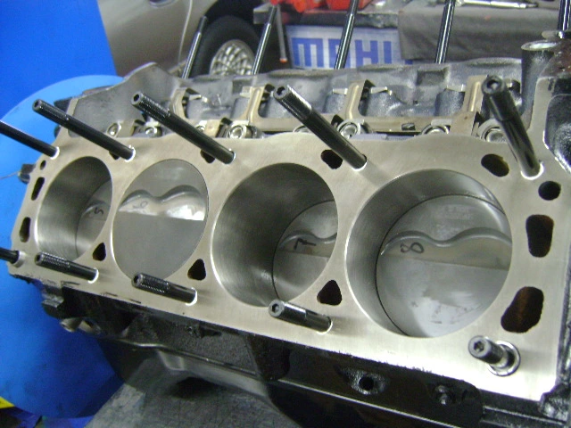

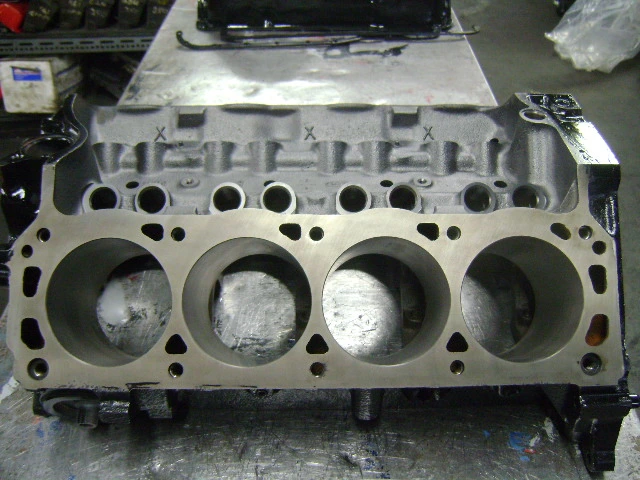

Curious,if you looked at these pics?....would you say that was a rough finish?...ive seen some all grinded mine looks not bad?...didnt take pics of mine yet but this was new?

So for cometic gaskets the deck surface needs to be laser straight and a different RA than for regular HG. Are you pulling the block and having the deck surfaced?
I was going to try the copper spray route?....some ppl say I'll be fine some no??,wanted to try that first,but I really don't know what to do now.......new heads is my best bet but more$$$$
