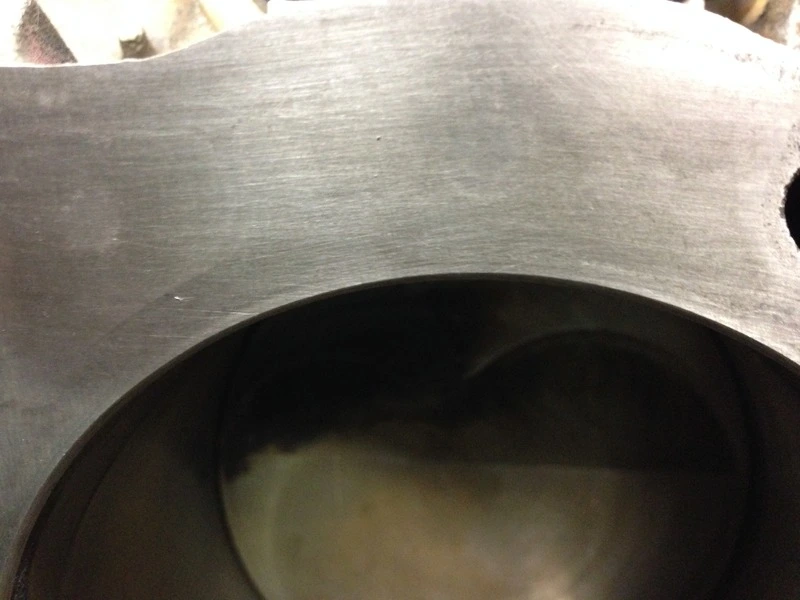

This is my block....red scotch brited?

Problem is the head?...block checked out fine??...im sending the head out for measurmeant and resurfacing?...tuner agrees?...not sure what else i can do?

I measured head in question with the proper machinest straight edge and its .004 out across the 2 cylinders that blew through,plus the fire ring indents=blow through i would say no?....and thats sitting over the ruff indents from the fire ring of the wrong felpro 1011-1,so its hard to tell exactly,ima let the machinist double check for me....
But as far as i can tell,the block was flat,couldnt get .0015 through in any direction..
