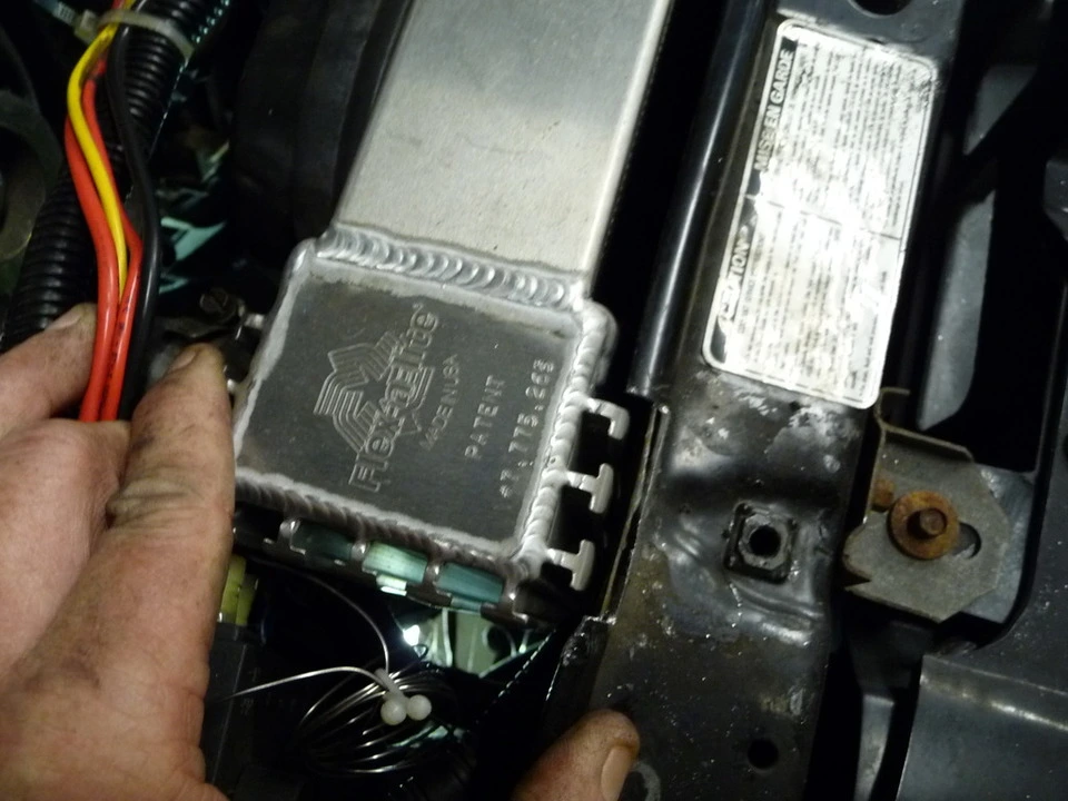

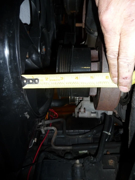

I'm hoping to get enough clearance to jamb the 6.87" 8 rib in there. Get a tad extra boost from the larger pulley. Once I shoved it up enough it went forward. Really tight on the hood close now. LOL

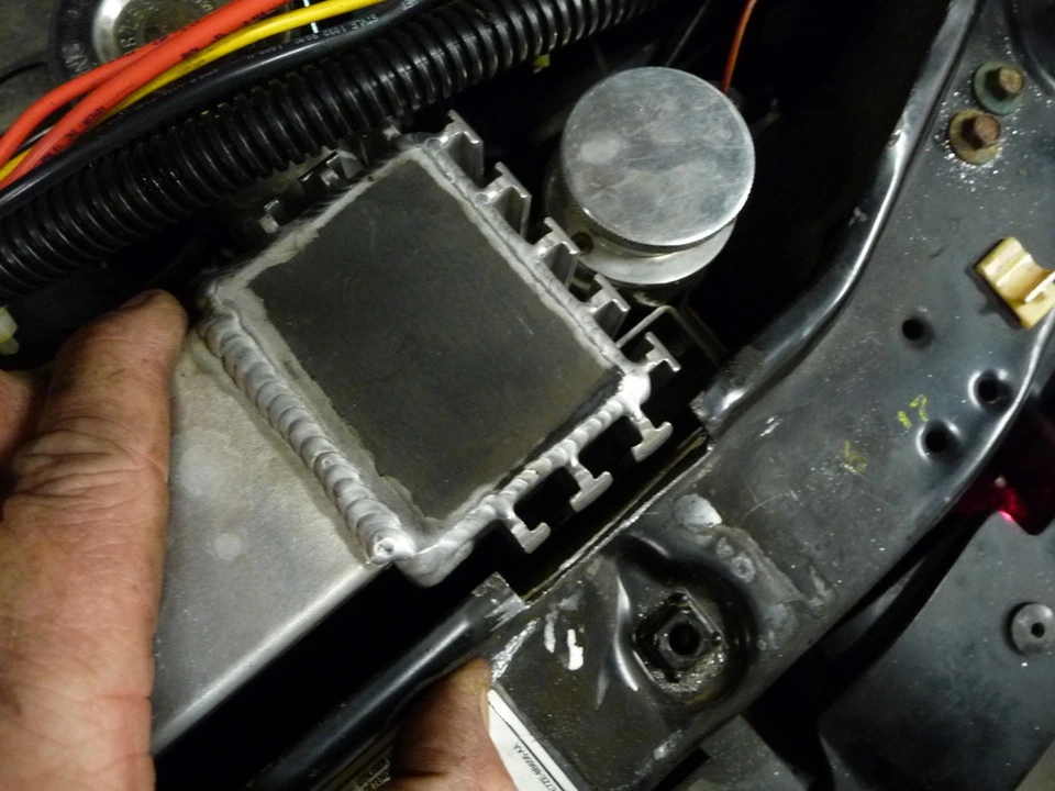

I cut some pads out of heater hose and shrouded them with sheet metal as pads to keep the core support from digging into the tanks. By golly, I think it might work!!!

My rad is pretty thick . The pulley has maybe an 1/8th between itself and the fan . I'll take some pics for you either way

Gonna have to modify the upper rad brackets to allow the hood to close.

john, a couple of thoughts
1. very envious of that garage man.. if you were closer, I'd be hitting you up for space to work on my car ,,lol
2. just get a stock crank pulley for $20 and use the stock 6 rib vortech pulley. Sounds like you are killing yourself over this and the U/D pulley adds maybe 5-10 hp above 3500rpm.
3. I used MKVII fans with my Vortech setups, I had to trim the fan shroud and move the radiator forward a little.

The 6.87" pulley I'm trying to fit would also yield me some extra boost. Can't frown at that right? In the end, I'm the kinda person who would go overboard for a few extra ponies. When every little thing is right, it adds up in the end.

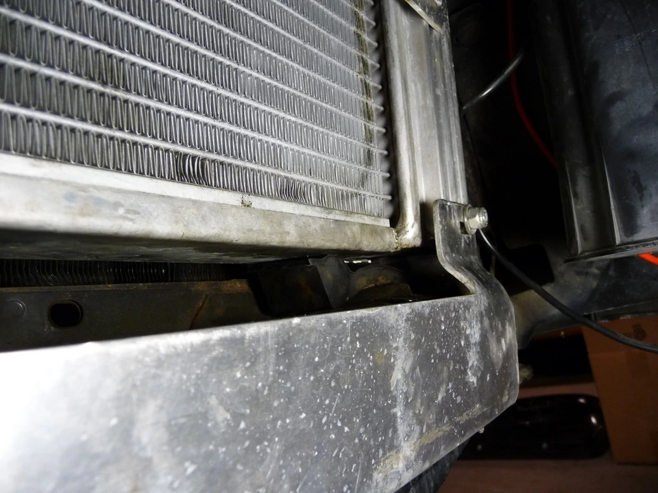

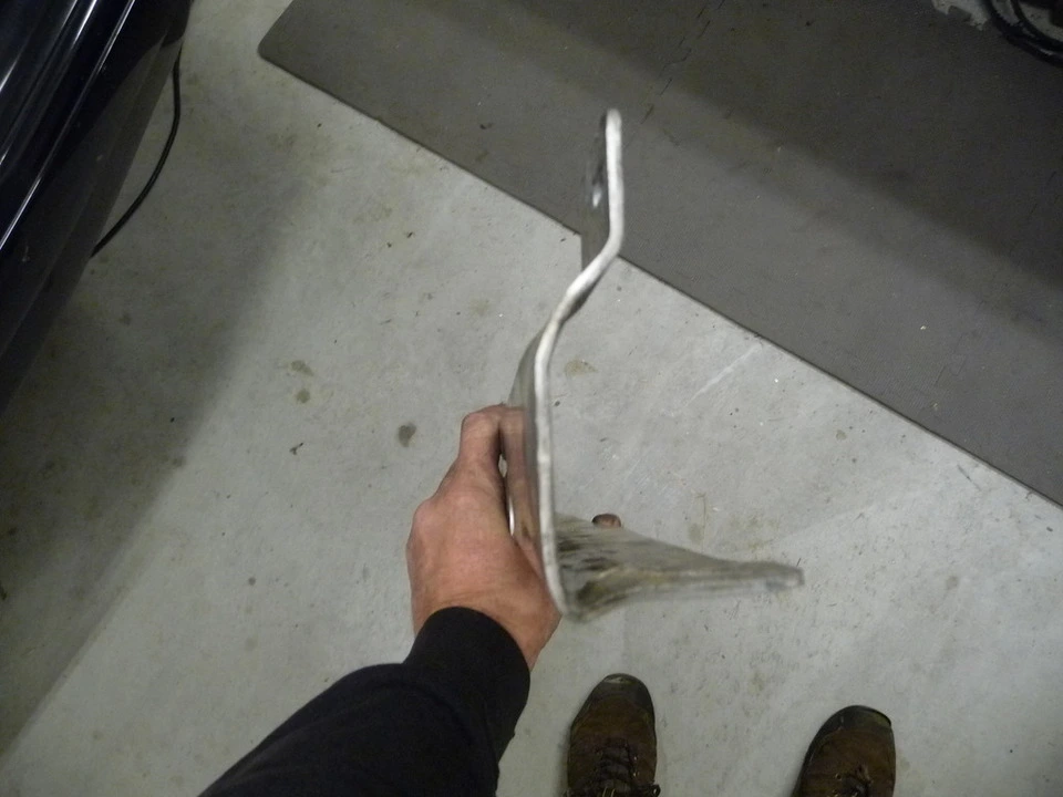

Done with rad mount mods. I got about 7/8" extra out of it. Question > how much deeper is an 8 rib compared to a 6 rib? I'm guessing about 1/4"
Notched the top support and remade the brackets.
Modified lower bracket by bending and shoved the rad up and forward.
Got an extra 7/8".
