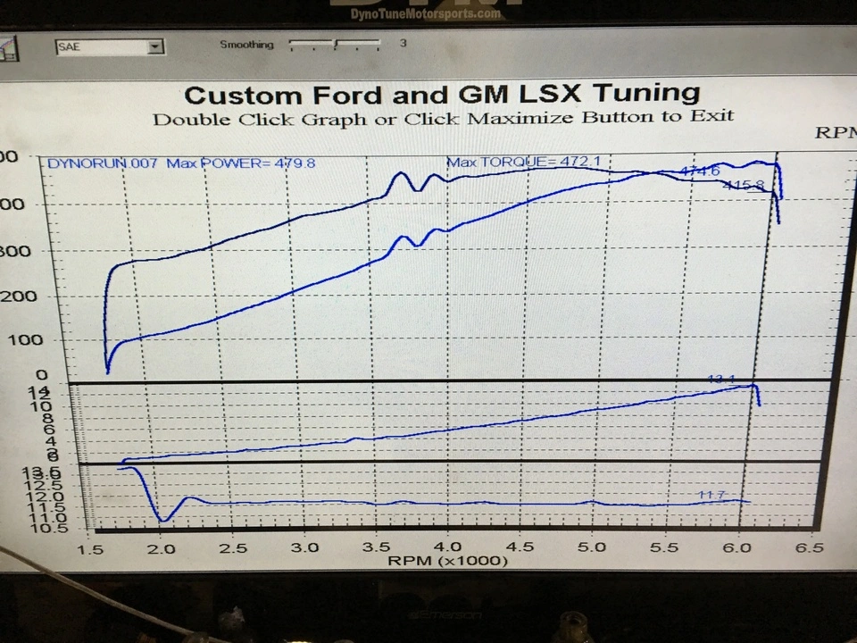

I should really take a scan of the print out but it's out in the garage and I'm too lazy, so here's a picture of the computer screen.
479.8rwhp
472.1rwtq
13lbs of boost @6000rpm :O which is a little more than I was expecting lol
Had just a few small issues.
First issue was the supercharger belt was slipping. Apparently shoulder tight isn't tight enough lol. We took a block of wood and gave the tensioner bracket a few love taps (after loosening it of course) and that seemed to do the trick.
Second issue, with 4.10 gears, street tires, no weight in the back, and damp conditions, we had some wheel spin. Put a couple big bodies in the back and it was resolved.
Third issue was some misfiring above 5500 rpm. Ignition is mostly stock save for a MSD coil, 3924 plugs gapped at 0.028, FRPP plug wires. I thought an MSD box was in my future, but after he made some timing adjustments it went away and ran great. I don't really plan on revving past 5500rpm very often anyway. He said the timing was set at 20*.
The drive home was rain and even some slushy ice on the windshield, so I didn't get to play with it any.

Great results for sure! That torque number is HUGE and should make it one heck of a ride on the street. Are you looking at putting a set of drag radials on the car at all? Obviously not the best choice for the rain but they will change the car completely on the street
The car was a torque monster even before the blower, made a little over 340rwtq. I credit the AFR 165s, Performer intake, and putting the Trick Flow #1 in +2 for that.
I really need to invest in some Nitto DR's. The car doesn't go out if rain is in the forecast. How many miles do people usually get out of Nitto DR's?
479.8rwhp
472.1rwtq
that's some insane #'s there.. 550 crank hp on a stock block!
I am getting my car Dyno tuned next week with the V3 on it.. It was around 292rwhp prior through an AOD ( 15-20% hp loss) with an HCI similar to yours and I want to only run about 8-10 of boost ( stock block).. I'll post my dyno sheet. looking for around 425rwhp..
Reactions: 84Ttop and A5literMan
Don't be surprised if you make more lol. Mine has a 3.33" upper and still made 13lbs, but I also have a power pipe.
yep- got the powerpipe. A stick transfers about 5% more than an AOD to the rear wheels as it is more efficient. My tuner and I agree to try and keep the block in 1 piece than trying to squeezze out every last extra hp. 475rwhp and I'd shat a brick..lol

Nice numbers. I'd say you've pretty much got those 42lb injectors tapped out.....and the stock fuel rails for that matter.
94% duty cycle at 6000. Going to get an aluminum driveshaft and then start saving for a Dart/FRPP block and fuel system upgrades....$$$$
Try a 3923 autolite plug, 1 step colder. Nice numbers.
Not worth it in my opinon unless the car sees more boost, 16 lbs or more i would be a buyer for sure.
You run the stock heat range? Interesting.
Never had an issue and never burned up a customers motor ( i mean we've only done a few hundred ). The driveability is better with the hotter plug and so long as they are gapped tight there isnt an issue with spark blow out
thought 3925 were stock heat range?
