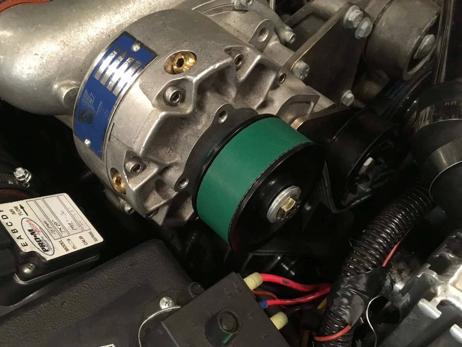

Popped the factory seal. Ready to go with 6.87” crank and 2.95” on blower. Just waiting on the correct idler pulley which comes Monday.
After trial and error, the 8 rib Gates Fleet Runner K080545HD belt fits perfect giving at least 2/3 wrap on blower pulley.

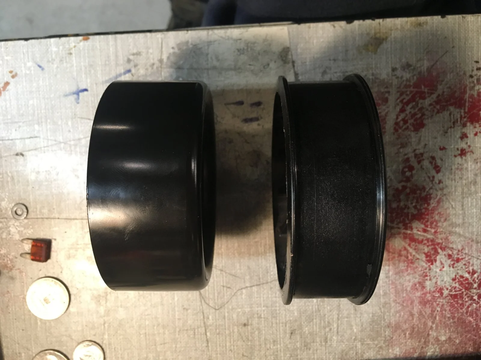

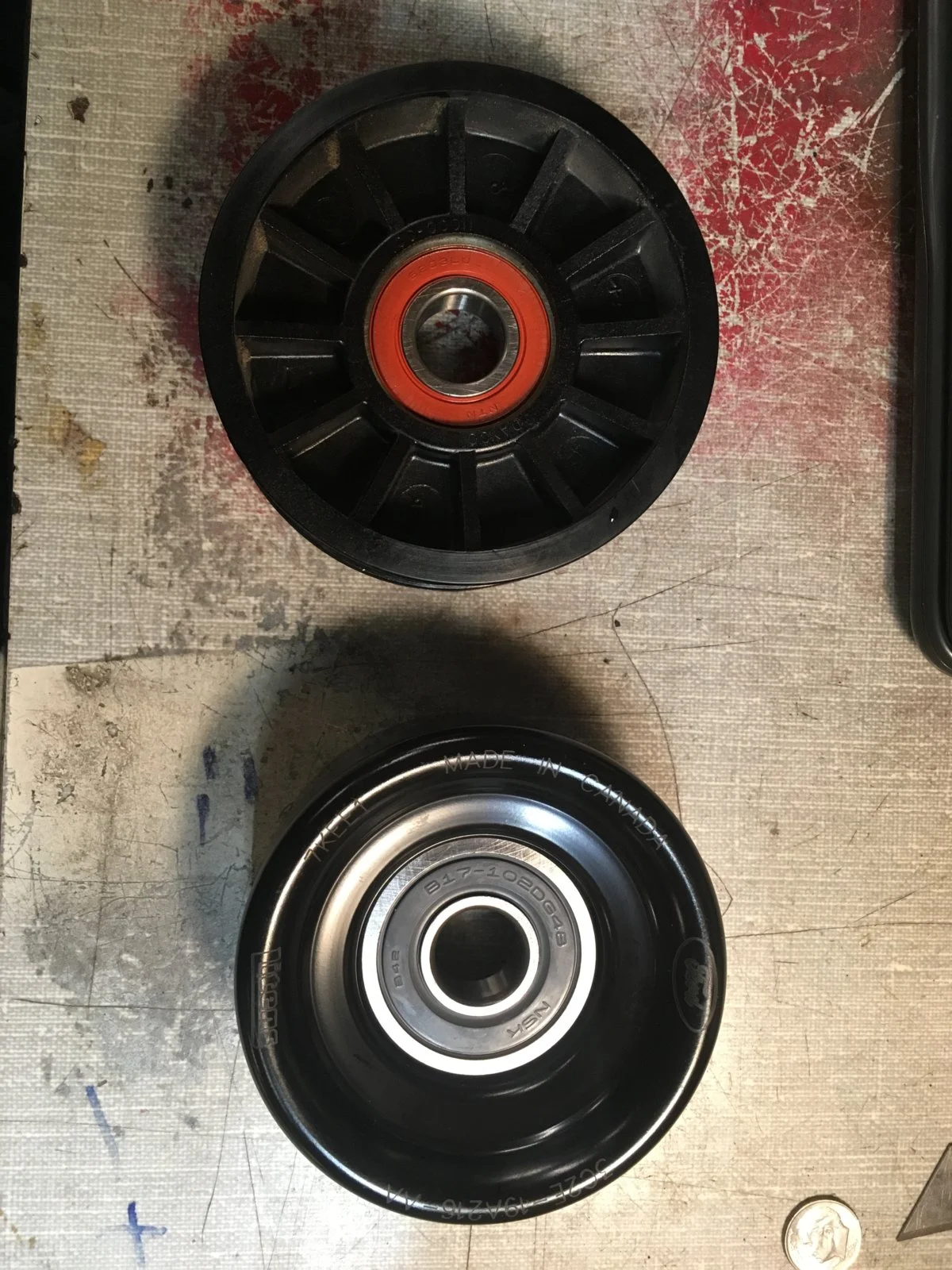

The 8 rib smooth pulley that was ordered directly from Vortec is actually a Ford Motorcraft part oem on trucks. Here it is exactly. About 1/2 price at Rock Auto. I wish I would have known that.
https://www.rockauto.com/en/parts/motorcraft,YS292,idler+pulley,6956
Here it is next to the 6 rib flanged pulley that I removed
Here’s a short vid of the belt wrap at blower pulley.
